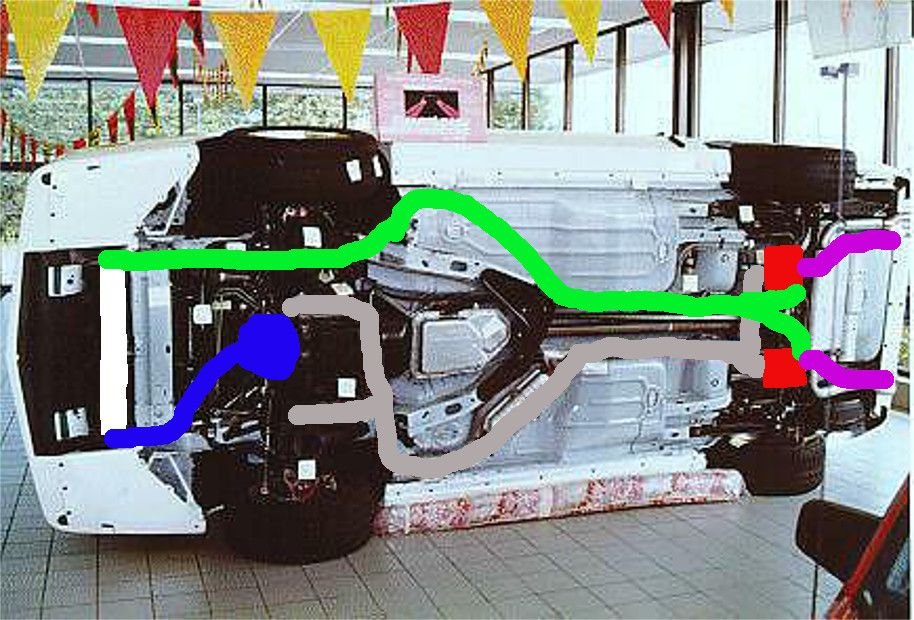

Rough drawing of my current plan
Green Charge Air
Blue Cold Air
White Intercooler
Red Turbos
Purple Turbo Exhaust
Grey Exhaut

Sorry to hijaak, that is a cool pic do you have a hi-res version? Thx!

If everything is sized right, singles spool well. For rear twins it complicates things more with twice as many pipes but could prove to be good for space and still get good power/response
