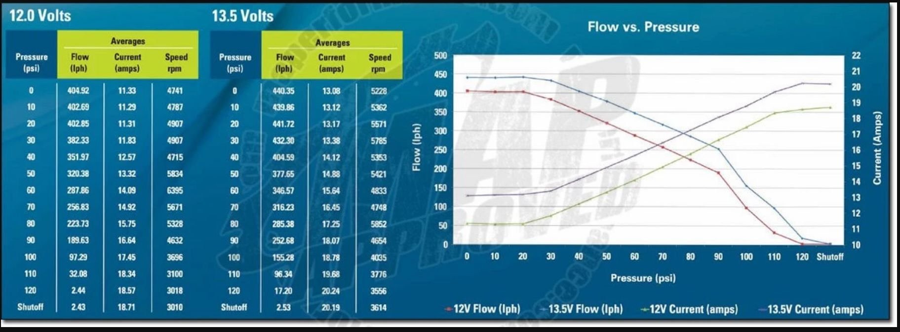

So I found the root cause of my fueling problem.
Under boost, my fuel pressure ramps up as expected, then suddenly drops to around 18psi and leans out (see below image).
Another thing I noticed. Voltage at the battery or alternator is 14.5 or so as expected, but voltage on the supply or feeder side of the fuel pump relay is only like 11.5.
I'm tempted to swap the supply to direct battery (through a breaker), a new relay, and a new 10awg feeder to the pump, but I'm curious if this is a wiring issue or pump failing.
I find it odd that the pump is perfectly fine until a certain point, it seems like a volume issue when my injector DC goes up. But I guess voltage drop could cause that too.
Unfortunately, I don't have a easy way to monitor fuel pump voltage while driving.

If the pump is undersized then fuel pressure should glide down, not just drop off suddenly.
Voltage across the pump definitely has an impact on the flow rate. The pump manufacturer probably has performance curves at different voltages to give you an idea what it can do.

I hope you upgraded the wiring.... My walbro 450 pulls something like 18amps at 70psi or something like that. You should be running at minimum 14 gauge to the pump through the tank from a relay close by, but 10 gauge to a relay by the tank. I just ran 14 gauge from my rear mounted battery as its less than 6ft worth of wire.

So it looks like the factory wiring is 14 or 16 gauge. Which is interesting considering the fuse for that circuit is 20 AMP.
I removed the factory relay yesterday and installed a new 30 amp breaker and relay direct to battery. I'm going to run some 10awg from the relay to the back of the car.
I did a voltage drop calc, and if I leave the small bit of wire from the sending unit connector to the pump itself voltage drop will be a about .068 volt, which is acceptable.
Guess I'll give this a try and if it still has issues I'll swap the pump again. Pump was installed in 2014.

Just doing some math on this.
So I was at 72% duty cycle on some 72.4lb/hr injectors. I'm using a Walbro 400.
I know my fuel pump voltage was 11.5 because I was getting voltage drop.
My fuel pressure right before the pressure drop was 54psi.
Looking at this chart:
I'm going to assume my volume was just under 300lph.
Now, if you calculate the injector flow at that duty cycle and pressure, I'm coming up with 468 lbs hour of fuel delivered, which is 294 liters per hour.
So there is a good chance there is nothing wrong with the pump at all, just can't keep up at that voltage.
Based on the wideband data at wide open, it appears the injectors are required to keep the AFR up but the pump might not be enough to satisfy the injectors at this fuel pressure. My regulator goes roughly 1:1 with boost.
Hrmmm..
-- Joe

Thats the chart for a Walbro 450 not the 400... look at the flow at 13.5v thats how you know. your putting a solid 50lph less at any given pressure. With that being said it also pulls 15-16amps at your base pressure of 54psi. Once you add 10psi or more the pressure shoots up to 64psi + which flow continues to drop but your amps shoot up as well. If your on the stock wiring then its for sure your problem. However the walbro 450 comes in 2 flavors, the regular 294 I believe and the 274 which is the high pressure version (might have gotten them mixed up). But the regular in the graph has a 90psi check valve hence the cliff drop off, the high pressure version I believe has a 110psi check valve and its perfect for LS base plus boost. I have both but have the low pressure installed as I don't really feel like dropping the tank ever again lol.
FWIW the walbro 450 should have no issues supporting 800-1100hp on pump gas, but your high base pressure plus boost is pushing it into its uncomfortable zone of flow drop due to pressure. I would rather you drop base pressure and gain the flow back. But if you wanted to upgrade a simple high pressure 450 should be more than enough for those 72lb injectors at 100%.
