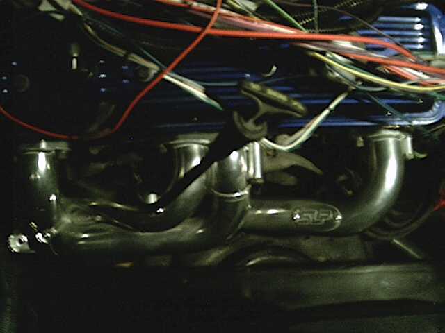

yeah, I really don't know what i'm doing. I just like giving bad advice. I tell you what, let's all post some pics of our cars, and engine compartments. I'll get out to the garage tomorrow and take some pics of the car. But for now, here is a recent pic of my engine compartment...bare with me,it may take a couple of weeks to throw the rest together, I am in the process of hacking some pipes up for the intercooler..
Attached Thumbnails changing in tank pump... is it difficult?-motorpicsforinternet-003.jpg
Old Feb 4, 2002 | 11:18 PM
StockBastard's Avatar
Posts: 90
From: Springfield MO
LOL
hey BB what times do you plan on running with that thing?
Old Feb 4, 2002 | 11:20 PM
BlownBird's Avatar
Posts: 475
From: NewCastle,DE USA !
I'd be happy with mid 9's. Not bad for a hack job..LOL:lala:

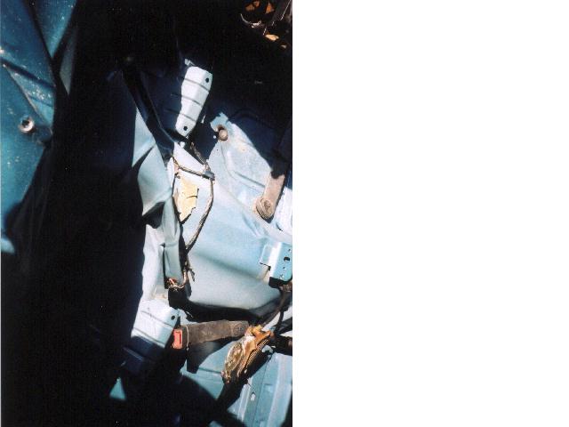

Yea i'd like to see how well that helps when some idiot hits your car, heres a pic of the inside of my 94 just to give you an idea, i think i'll keep my unibody car 1 piece.....

Axle/Gears: 3.54 R200 IRS
Smart reply, that was a pic from my 94' which some 70 yr. old idiot plowed thru and then it spun into a phone pole, completely his fault, damn you really sound smart now, with every post i seem to be more drawn to take advice from you ...... NOT
