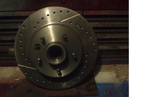

How do you like the agx's ? I think i may go with them, our suspensions will be pretty darn close.

How come it looks like your rotors are on the wrong sides, i could have sworn mine are marked and would be the opposite from what i see in your pics......
I don't know what to tell ya'..............
It doesn't matter how the drill or slot pattern rotates- Many companies will do it differently. What you need to look at is the direction of the vent fins. The fins should be mounted in the direction to allow rotation outgas. You don't want the fins to catch air and force inward towards the rotor hat. This will cause bunching of brake pad material in the vented areas.

AFreaknGoodTme, at a local vette show a guy brought his Lingenfelter Stage 2 car and they installed the rotors the opposite way of the way you'd recommend. I thought it was strange as did a few other people. Could you think of any reason why LPE would do this?
Its real simple -- somebody put them on that didn't understand the importance of direction. Happens alot, People often make decissions based on how something will look rather than how it will perform.
Im thinkin he was still just looking at the slots or drill holes and not the vanes........
If you look at the very first picture you can see that he has the vents in the rotors running in the proper direction. The front of the car is to the left of the picture of course. They will rotate counterclockwise in the picture and the vents will off gas outward. If they were switched to the other side then the vents would catch air forcing it inward to the center of the rotor - the problem lies where the brake pad material can not off gas outward and starts to bunch up in the vents of the rotors. So again, Tom does have them correct.
No, i meant the person who said the ones on the other car were opposite of tom's, as in the slots, like i said, mine twist the other way, but thats how they're supposed to go on...

Heres the left front one to mine.

I understand the right way to have the rotors. The slots make no difference, it's in the vents between the rotor surfaces. What difference would the slots in the surface of the rotor make while rotating if they were facing towards the center as opposed to facing away from it?
There really is no difference from what I have seen first hand over the years. I use to follow Trans Am Series racing alot an would always check out the car is the pits at Long Beach Grand Prix every year to see the tech advancements. Every year those guys run many different slot designs and all running different directions- It never appears that one design has better stopping power than the next. They just cant run drills because of the extreme heat they rotors are under would crack quickly from hole to hole. Slots dont penetrate through and weakin the strength of the rotor where as drills do, however, on street car you will never come close to the 1400*+ heat they run at. You'd be luck to breach 1000*.
So it'd probably be best if i got a spare set of stock or slotted only rotors if i start racing in scca ?

Ahh, are your inner tie rods on backwards? Usually the nut faces foward and from the pics you have the backside of the tie rod facing foward.
Yup - its on backwards.
The center link is on the wrong way... and the tie rods as a result are on the wrong way too.
Better switch that around or your steering geometry will be all messed up.
Shoulda taken more pics BEFORE you took it all apart so you could remember how to put it back :P
Just buggin ya' Things are lookin good Tom. Have fun.
Old Jan 12, 2003 | 07:20 PM
  #43
Tom Keliher's Avatar
Posts: 849
Holy smokes!!
You are right. What a dumb ***, LOL! I should have bothered to look at the manual. I just looked at the old steering linkage laying on the ground and assembled the new one the same way. Obvious now that the old linkage had gotten turned around. Oops, heh-heh.
THANKS for the heads up Justins86bird and Hunter Motorsports!
Back to the garage we go.......................

All better now!
I swapped the steering linkage after work today.
