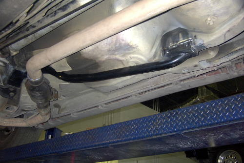

Old Feb 9, 2003 | 08:39 AM
88txiroc's Avatar
Posts: 1,195
From: San Antonio, TX
The Alstons rule! Perfect fit and really makes the car tight. Here is a pic:

88txiroc's Avatar
Posts: 1,195
Originally posted by gtaguy87
Where can you get the alstons? do they require any exhaust changes?
You can get them from Alstons website. They are on the high side, a little over 200, IIRC, for the weld ins. They require no modifications at all. Everyone I know who has them would never change. We all recommend them every chance we get. I did a lot of research on these, and they are by far the best out there. I know others will disagree, but they most likely have not had them, nor driven a car with them on. HTH
