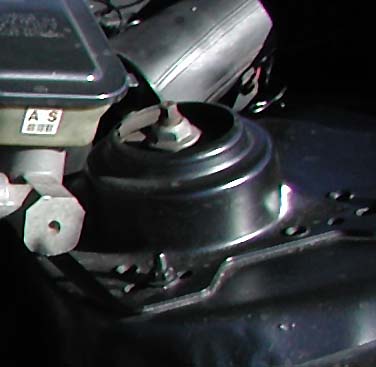

Slide the strut forward/backward?? There is no sliding to be done to adjust caster. Our strut towers don't have the provision for vertical shift. I have a pic of mine below and you can clearly see that the holes are only horizontal. You could cut away at the tower I guess but that would jeopardize the stability of an already weak element.

These provsions you speak of for "vertical shift" as you call it are already in the tower. Look up in your wheel well and you will see them. On some cars it is necessary to lengthen these slots in order to get a performance alignment. Just be sure to use a quality strut mount, high quality bolts, and make sure the tower is not rusted or detriorated.

Ok, yes it can be adjusted, but not enough to make a difference or even pay attention to. It can only go maybe a half of a degree. The slot IS NOT THAT BIG. The bolts can only move left to right. Not back to front.

I finally got a chance to scan the diagram for you of our strut towers. You will notice the bolt holes are only elongated side to side. This leaves MAYBE a full degree of adjustment for caster but even so Thats not enough to even consider an "adjustment".

The slots are as long if not longer than the slots in the strut mount. I have aligned many of these cars for racing and everyone I have done has had these slots.

These slots though are plenty long enough for an adjustment. I had mine done this weekend and my right caster is 3.6* (just under 4* is desirable) and the left caster is 2.4* (left camber is always preferred lower due to road grade).

I already mentioned this. Your caster changes as camber is set. There is not that much change to be done as far as caster goes on these cars. stock caster setting is 3.0 and it doesn't venture very far from this. BTW- the adjustment of the left caster is not only unneeded most of the time but that great of an setback throw off is killing your front steering geometry. I can only imagine how bad it pulls

you can move the strut mount and get a camber change w/o a caster change. i do this all day long 5 1/2 days a week. because i own a suspension/alignment shop. so, your caster doesn't change as you adjust camber on our cars. and caster changes alot there is as much as +/- 1* from center of the slots. i don't where you come off with it's not enough to make a difference. you use caster to offset road crown. usually only to about .50* higher on the right. with burnoutrpm case i agree 1.2* spread is a bit much. but whatever works to make it go straight.
http://www.fl-thirdgen.org/alignmentspecs.html
i made this page getting the specs from my hunter p611 alignment machine. as you can see from 82-86 they used 3* +/- 1* 87-92 they moved it up to 4.80 +/- .50*
