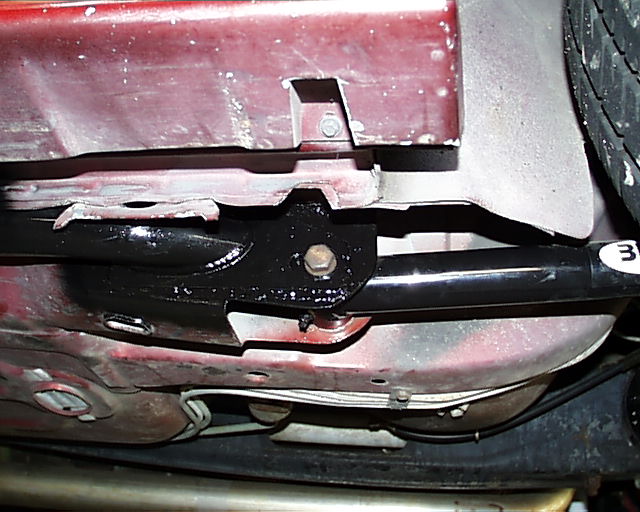

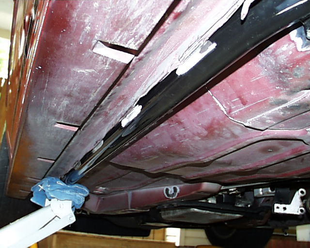

Thought you guys might like to see more pics than what Steve has on his site.
The install went pretty smooth. Be careful with the heat and don't blow a hole in your floorboard...it sucks. I think I fixed it tho.
Anyhoo, like 383 mentioned, I felt I needed to bridge the gap a bit between the floorpan and the SFC so here's a pic of some metal I cut and damn if it didn't fit just about right.

Here's a shot of the driver's side and where I sanded and grinded the paint away to weld. These SFCs were coated with POR-15 and I will recoat the welded areas with it also. I just picked out areas where the lip was closer to the SFC and welded there.

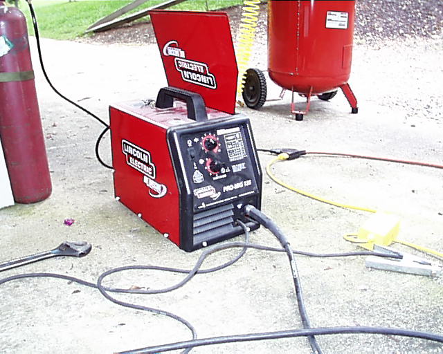

Here's the little guy that did all the work. These little 115V MIGs are the cat's ***! Nice little units for us DIYs, and run about $400.

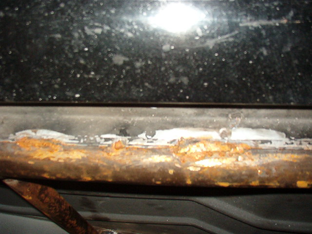

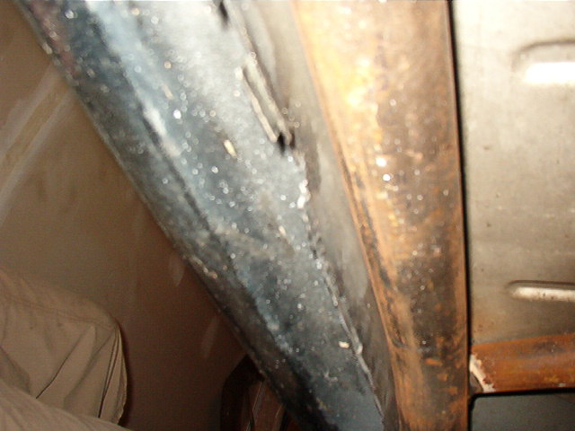

my grandfathers mig wouldnt weld worth a crap so we used his stick welder that did the trick.

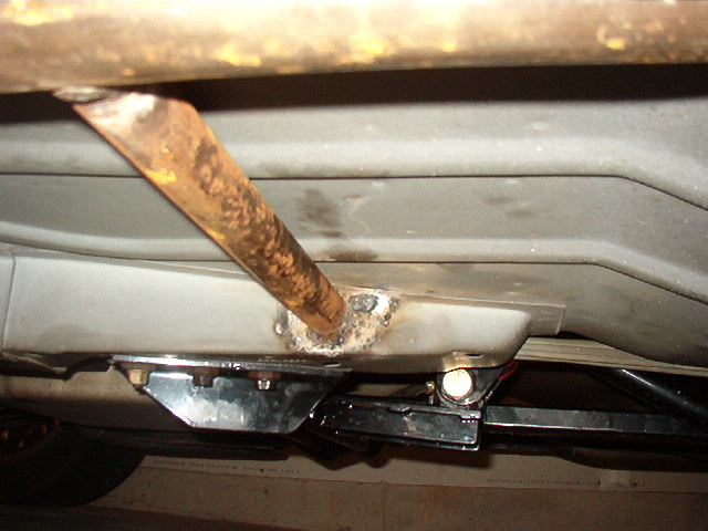

more pics sorry i couldnt help myself

eb your installation looks like it will go really well.Did ur sfc's come uncoated and u not paint them mdformula.

Thanks. My SFCs were uncoated and I painted them with POR-15 (www.por-15.com). I HIGHLY recommend using it on any part underneath the car, and I think MD ought to use it before those new SFCs rust away...

I primed my bare metal spots after i was done then coated them with some rust prevention paint made by SEM.

MdFormula350: In the fourth picture that you posted... is that with or without ground effects installed? It *seems* to me like they're installed, but then again, I've never seen one of these cars without the effects installed.

my car is a formula, so no ground effects.
anyway it was at a angle from the floor, you cant really see them if i drive by and u were standing up..

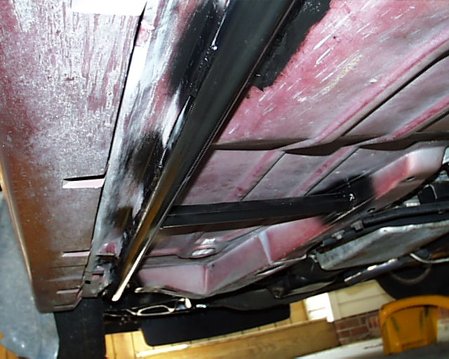

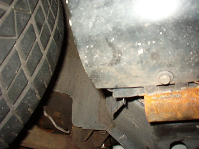

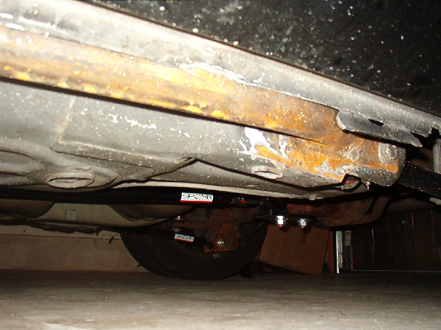

Here's pics of my finished install, all painted with POR-15 and purdy.

Area near the cat:

Back by the LCAs:

awesome! :hail: i am just going to spray paint mine

awsome install very clean look how does the car feel now

Hey Ebmiller is that the lincon wedler from like homedepot that sells for like 437.99 or something very close to that? becuz im lookin at the very same welder so i can do some stuff to my car but my big question is do you have to get a dedicated line to run just the welder or will like a regular plug out in the garage work? and is there much of a difference between 110v and 115v? my parents kinda dont want to have a big problem with me like tripping the braker everytime i go to weld so thats why im holding off on gettin it.

Yep, that's the Lincoln Pro Mig 135 and it runs on regular 110-115V house current...you could run the thing in the kitchen if you like. No significant difference between 110 and 115V , just how companies choose to market their products. I only tripped the breaker once and it was because my air compressor, plugged into the same outlet, was running at the time and I fired up the welder. It was a 20A breaker, so no big deal. If you run it out of an outlet my itself I don't think you'll have any problems. These are nice little welders. Go for it!!

thanx Eb, i think ill be hittin up homedepot this week.
