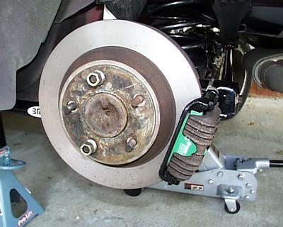

http://www.pbr.com.au/pbr/rwp.nsf/He...play/Home+Page
PBR makes the brakes for a LOT of cars out there, including Corvette, LS1, 1LE, etc.... They make the aluminum front or rear calipers for our cars. The iron disc brake calipers are Moraine. Here's a pic of them when I did my rearend swap. Moraine:
Attached Thumbnails later PBR 3rdgen rear disc brakes are the same as the LT1 rear disc brakes right?-old-rear-prior-removal..jpg
