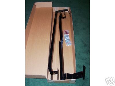

cgschassis is selling these for $140 on ebay. I did not see the ones you are talking about on there. But I am also looking for a good set of subframes for my 86. I bought all the BMR adj. Stuff LCA's, Panhard, and Track pack torque arm kit. I need to find a good set of subframes so I can tie them togethere with the cross member from my new torque arm kit.
Tony

I found the sfc from dshop2000 on ebay. heres a pick

I bought the CGS ones from e-bay.Beefy as Hell. The pics don't do them justice. The flanges are thick and sturdy.They even have flanges already installed to bolt a cage to.I haven't installed them yet,I'll let you know how they go.They came with a help line.
My only gripe is no pictures with the instructions,They are worded very well but some pics would help out a bunch.The directions say install time is 3 1/2 hours and that is bolting them on,so add a hour for welding then it's almost 5 hours to install them.
WOW most don't take that long do they?
