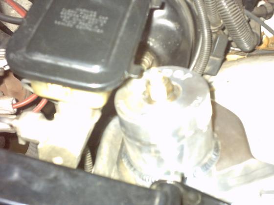

Here's a picture of my current setting at about -.8* camber on the drivers side. You can see the minimal clearence if moved towards the MC.

id like to point out that for a street driven car, 99.999999999999999999% of us are never going to set it to more then 6*.. thats a heck of alot for a street car anyway.
so no worries.
