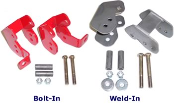

just buy the bmr bolt in lcas, thunderracing sells them , they are great and then you dont have to worry about alignment . And if you want to you could weld them in . The locate off the original hole and off the hole that the shock goes in .

I already have the brackets, I just wanted to know if there really is ever an alignment issue

Weld both of the brackets and the same spot and ull be good.

if you weld, you do that before you hook up LCA's. They get attached to the original LCA mounts on the rear end and I vote for having them welded in.
