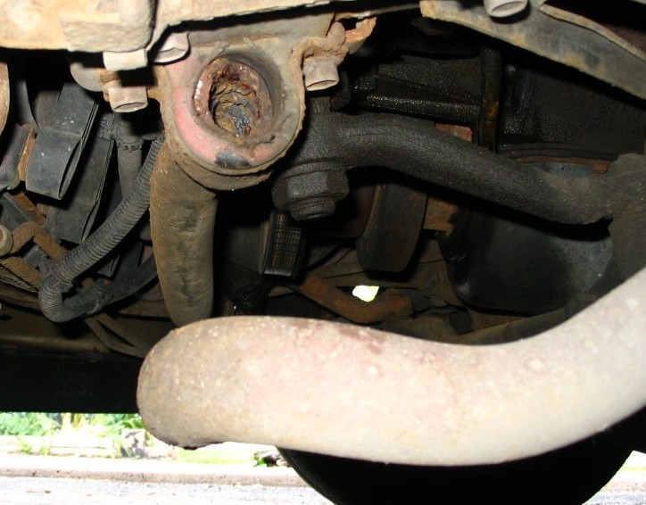

So I came outside this morning to my car not starting, hood struts shot when they were good yesturday, and this:
Their is a 3pt edelbrock stb, and a wonderbar on there and I managed to snap the thing?
The only undue stress I can think of is yesturday I took a corner too fast in the rain, and hit some sand. I went into a spin but got it under controll fairly quickly.
Has this happend to any of you guys or is it just a freak thing? I'm debating weather to throw on the spare 36mm hollow I have or the 34mm solid.
Edit: Looking at the pic now it looks like it's rusted out inside the bar, maybie that's what did it in although the metal on the break is clean.

I've been road course racing with hollow GM bars for years now, sticky track slicks and bumpy tracks like Lime Rock and Pocono...never snapped a swaybar.
There was definitely a contributing factor in your breakage, maybe the internal rust as you pointed out or something else going on.

I the upper left hand corner of the bar, it looks like it might have been cracked. Not surprising considering that is where the bushings wear. Take a good look at the break, i bet there is a deep scratch on the outside near the break. I wouldn't hesitate to put the hollow 36 on there, but i would (as i am planning to do) polish it up, remove all paint, inspect for cracks and repaint it.

just the other day i broke my 36 mm sway bar in the same location and probably from the same reason, rust. i came across this just from the corner of my eye one morning and i was amazed to see it broken, well i got another ready to bolt on asap. I'll post a pic asap.

36mm broken sway bar
here it is.

Looks like that's been broken awhile, maybe that hard steering just popped it out of the mount.
OR...you built up too much under hood heat and it radiated into the sway bar causing the NOS to overheat and force it's way out Next time install a sway bar internal pressure gauge and keep the pressure at about 1000psi.

Alot of times the tire rubs on the bigger sway bar under severe turning(u-turn,Lk to Lk).Perhaps when you spun out in the rain.The tire may have been rubbing while rotating & exerting a little too much force on the swaybar.Thereby shearing it off at the mounting bracket?Extreme example,but plauseable?perhaps!Maybe?

I've never heard of them rubbing. Interesting theory but it was a left turn and the left side broke so if either side was rubbing it would have been the right.

If it was a left hand turn & you spun out.That means the rear of the car swung to the right.Making the front tires point as if you were turning right.This could make the tire rub on the bar(they do rub).Assuming you didnt let go of the wheel of course.
