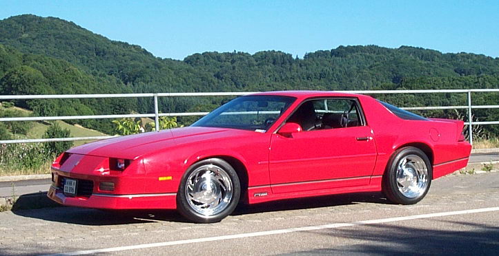

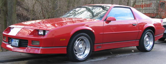

I installed my new prokit springs and am very happy with them. They drop the car approx 1" which is what I wanted and they handle much better. Although the ride is harder (expected) it's by no means punishing like the Suspension Technique springs I had previous. They drop the car approx 2" and the ride was unbearable. That's when I went back to the original springs. Prokit gets the thumbs up from me Pictures before and after

Your car looking really good
Got a question for ya what size rims are you running, look like 17 inch rims and If you could measure your ground to fender lip front and back that would be great..thax

I believe I have a pic somewhere with the suspension tech springs, I post soon, to the other question, I'm running 17X8 with 245/45 front and 275/40 rear. I get the measurement tomorrow as it is late night here in Germany.

black88cam- I did the measurements and came out with
front - 7/8 inch
rear - 1 7/8 inch from lip to tire. Hope this helps
