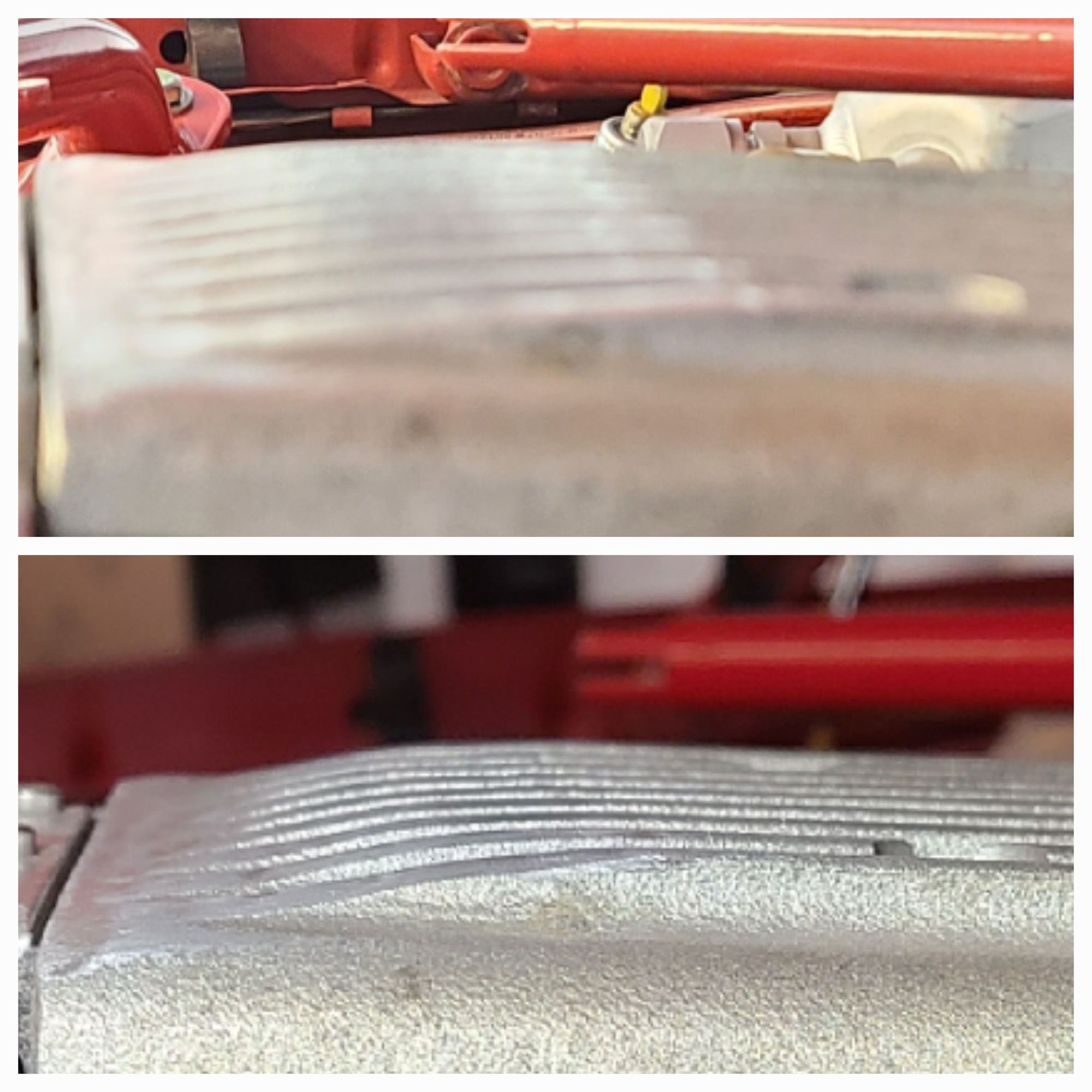

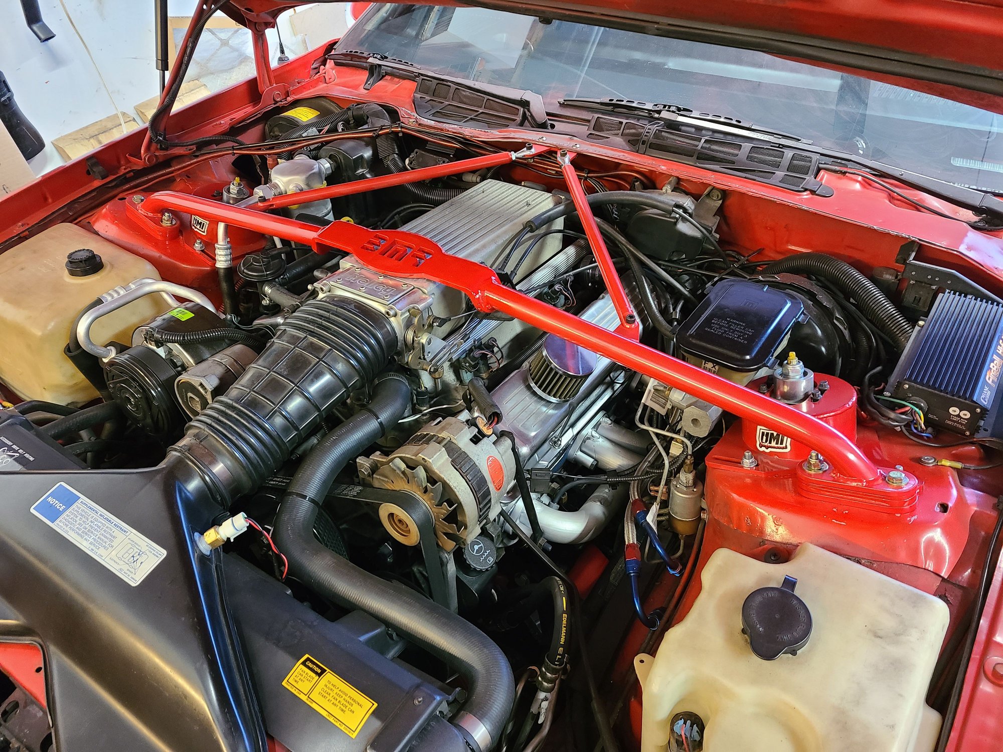

I've been wanting to put a STB on my car with HSR for years. I decided to get one and start playing with it.
Right now it still hits my factory 91 Z hood, and the current location only leaves a couple MM clearance with the motor, but I'm going to keep trimming the hood supports a little bit at a time and possibly grinding down the ribs on the intake, only where needed, to see if I can get it to work... My spacers are around 7/8" thick on each side currently.
EDIT: I should add, this is with fresh rubber engine mounts. I just swapped the engine last winter.
Clearance between STB and HSR plennum
The two lower black marked ribs are what seem to be makimg contact, i plan to trim those down a little at a time, and only where necessary.
The two lower black marked bracing are what seem to be makimg contact, I plan to trim those down a little at a time, and only where necessary.
You can see the scratches from hood contact with my first test hood slam closed.

Does BMR advertise this piece to work with the HSR? Just curious. I guess not surprising that it would end up in contact with the hood with that amount of spacers under the strut tower mounting points. A little angle mill / planing on those fins ought to help, then you could pull spacers, and maybe not have to cut the hood?
No, I called BMR and they specifically said it didn't, but it is still the slimmest offering where it goes over the plenum...
I think I may need to do all the above, and keep the spacers... I'm not sure how much the engine twists with rubber mounts, but I'm sure it's enough for it to touch the brace until I knock down the ribs on the intake...

Yeah, I would think that the engine torqueing over on rubber mounts(even poly mounts perhaps) could cause some touching. I would take the plenum to a machine shop and have them mill the top fins off and mirror polish it. I'd be very surprised if the cooling fins really allow for a temperature drop on the plenum.

I have had hard time thinking any intakes are taller than the stealth ram that fit under the factory hood. I had to move the Worm screw from my tb hose clamp to the bottom because it was wearing a hole in one of my hood supports.
I specifically made my spacers out of solid steel, I dont think I'm giving up much of any strength. May not be the case for other spacer methods...
I frimmed as much of the hood support as I was willing to last night. Still light contact, but if the stb and hood are both stationary, maybe it's OK? I'll have to see if it rattles or anything...

I trimmed as much of the hood support as I was willing to last night. Still light contact, but if the stb and hood are both stationary, maybe it's OK? I'll have to see if it rattles or anything...
If you cut the center rib out and make the hole slightly larger on each side then make a sheet metal box for that area and weld it in, then you would have the clearance that you need and maintain the integrity of the hood. I don’t think you would have to mill the fins on the intake if you did that.
Old Jan 12, 2026 | 12:19 PM
In the areas where I cut out the bent portion, it is really only one thickness of the sheetmetal still protruding beyond the underside of the shape where the blisters go, maybe less. I don't see anything more being removed from the hood without cutting all the way through, which I would prefer to avoid...
I'm leaning more towards chamfering or blending the stb. I can always reinforce it if I need to also... It's on a relatively steep angle which makes me think I would only have to be modifying the rear half if anything... I'll have to take a pic of the remaining contact tonight.
Clearly, it's really tight and I understand why not many, if any, people have pulled it off with the factory hood...

You trimmed that away very neatly. Someone who didn't know better would think it was made that way.

I ended up trimming the corners that were contacting still and called it a day. There is still very slight contact, but it does not seem to be enough to be a real issue, aside from rubbing the paint off in those few areas... I'm calling it a day for now, and we'll see how it holds up over time, the brace and the hood...
Top is final angle of the clearance intake fins (sorry for the poor focus), bottom was after my first attempt.

This would fit great with a few tweaks to the design. I'd make the two front bars mount to the strut towers like the two back bars do leaving room for some fancy adjustable upper strut mounts. Might would do something a little different where the upper back brace mounts to the cowl. This car also has a cross brace between the front subframes between the oil pan and the transmission.
Pair this chassis stiffening up with a DSE Wonder Bar and DSE subframe connectors and she would be pretty stiff.
