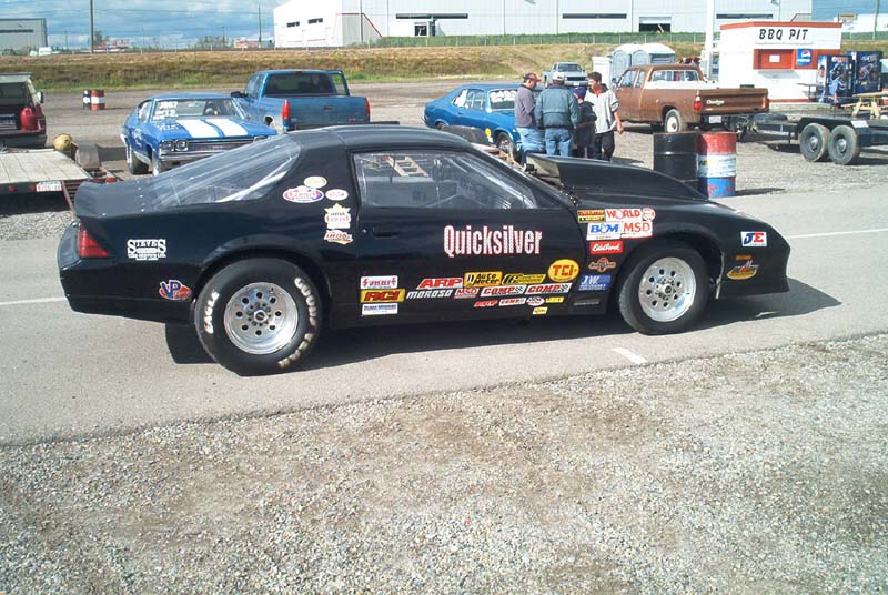

15 x 10 with 5.5 backspace tucks under third gen fenders fine. Since the shop recommended that size and it's wrong, they should cover the cost to get the proper ones.
Before I back halved my car, I ran 15 x 10 with 5.5" backspace for many years with different tire sizes.
I can't remember the size of my old Goodyear tires. I'm guessing 28 x 10.
With the MT tires, they were 29.5 x 10.5 but fender modifications were required to get them to fit.
The Hoosiers were 27.5 x 9
All 3 fit under the fenders.
I'm now at 32 x 14
Attached Thumbnails Need help fitting 15 x 10 bogarts!!!-profile3.jpg   Need help fitting 15 x 10 bogarts!!!-blackpearl2.jpg   Need help fitting 15 x 10 bogarts!!!-qs-aug2003.jpg
