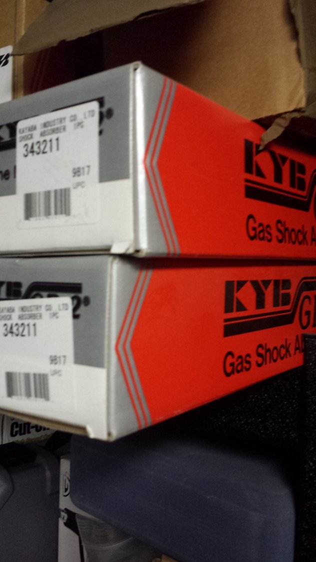

I never installed mine, new in box still and I'm doing a pre move garage cleaning so I'll have those up for sale soon cheap. I'll post my stuff for sale within a month, I need to take pics of it and have time to ship it.

Re: Best shocks for a 3rd gen.?

Are these for sale? If so, please PM me. Those are exactly the shocks I want to get for my 88 Formula

I don't like selling things for the most part. Not worth the hassle to me. I'll see first if the person who bought my supercharger wants them free, if not I'll think about selling them to you or putting them in the trash whichever is easier.
