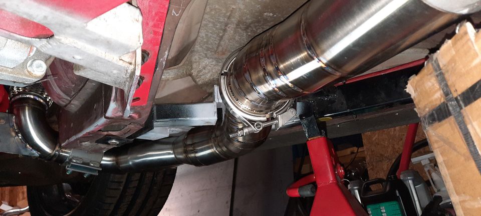

This maybe a long shot but could you post more pictures of your exhaust setup? I’m going to be these same SFC and am needing ideas for exhaust

I've put these connectors on both of my cars. One was a stock height drag car with long tubes where I ran the exhaust around the factory subframe and trans mount, unaffected by the connectors. The other is a lowered twin turbo street car with full single 4" exhaust in the factory location. I notched the connector braces on the passenger side to allow for clearance, and it's worked out great.
