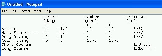

It's generally recommended here to go for a half a degree more caster on the passenger side of the car, to get rid of the car wanting to pull towards the sidewalk.
The settings above are quite different from stock settings (4.7 deg caster on both sides and +0.3 deg on the camber) Stock settings should be avoided at all costs.

So what is the difference between street and hard street use. And are you saying that 4.7 deg caster and+0.3 camber are the stock settings.I like to take my corners tight and fast, is that considered hard street use ? Which settings should I use for my type of driving that won't eat my tire's to fast.
Need some negative camber otherwise the outside edge of the tire will wear.
As for the pulling, any chance the rims were changed to ones that have less offset? That is moving the rim toward the outside of the car.
This will increase the scrub radius which affects the amount of force the wheel/tire will place on the steering.

Personally I'd run a combination of the street and hard street settings.
Camber -0.5 to -0.75
Caster 5.0 left and 5.5 right (or as close as you can get)
Toe In 3/32
The -1 setting for camber is for the people that like to have lots of fun with their cars, but don't do much highway driving. If you do lots of highway driving, aim for -0.75 camber at the max. But even -0.5 is still really good.
-1.0 camber can result in inside tire wear on cars that see lots of highway miles.
The +0.3 camber (stock) setting WILL wear out your outside front tires. Guaranteed.
You may or may not be able to get 5 and 5.5 on the caster setting. Lowered cars can get higher caster settings than stock height cars. And aftermarket solid bearing strut mounts tend to have more adjustment than stock strut mounts.
those are the numbers that Global West published in the early '90's or maybe earlier (I didn't get into f-bodies till '92 and that was about the time that GW was developing a lot of their f-body stuff).
You'll find that a lot of cars can't quite reach those numbers, as you move the caster + you can't get as much negative camber. I usually end up happiest with around -.75 to -1 camber, and then run as much caster as I can get with that setting (I've slotted the tops of the strut towers to get that up around 6, and usually at that point you're so far over in the strut tower opening that you can't run the stock strut rod shields). Oh, and usually set the toe to around 1/16" in.
More caster = more self centering and more stability at speed (dedicated drag car suspensions are often set to 6-10* just to make them as stable as possible). Toe in helps some also (toe out makes it twitchy, but gives you faster response which is why they use it for slalom). Enough negative camber will cause more wandering (and eventually hurt braking), but like others have said these cars need some to keep them from chewing up tires. Go around -.5 if you're concerned about it, but if you are pretty aggressive, then you'll want a little more (when I was younger I used to swear by -1 to -1.25*, got perfect tire wear and a lot of tickets)
