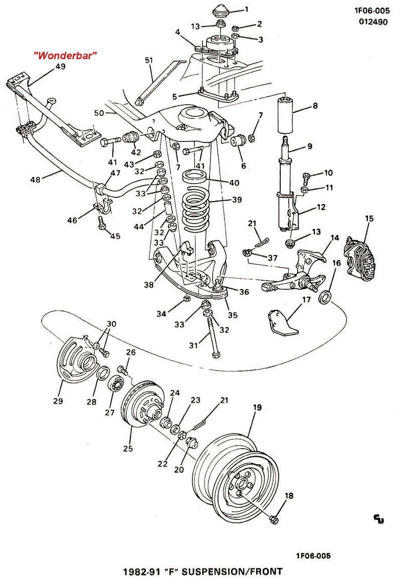

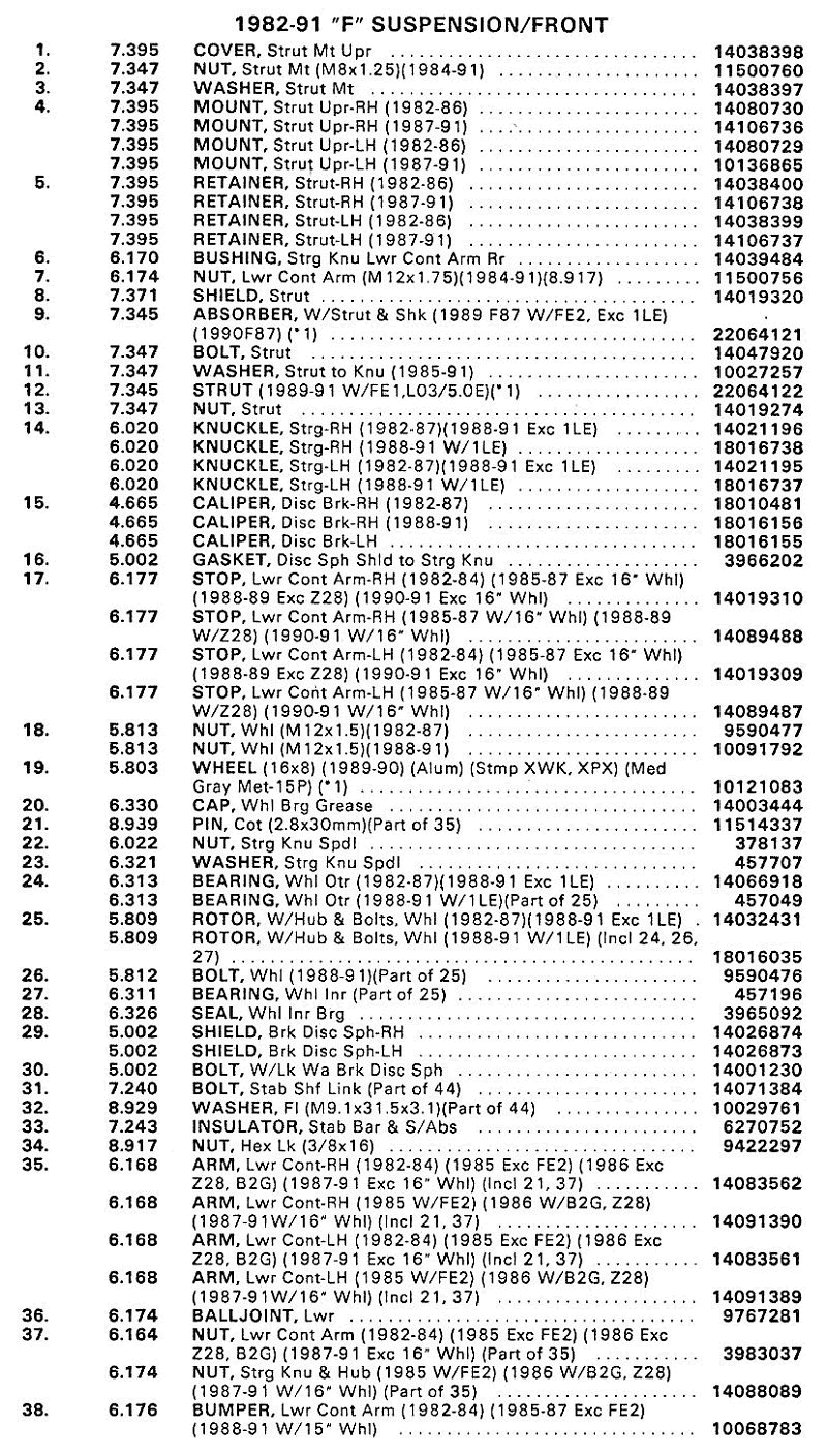

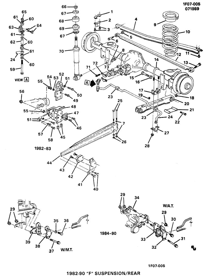

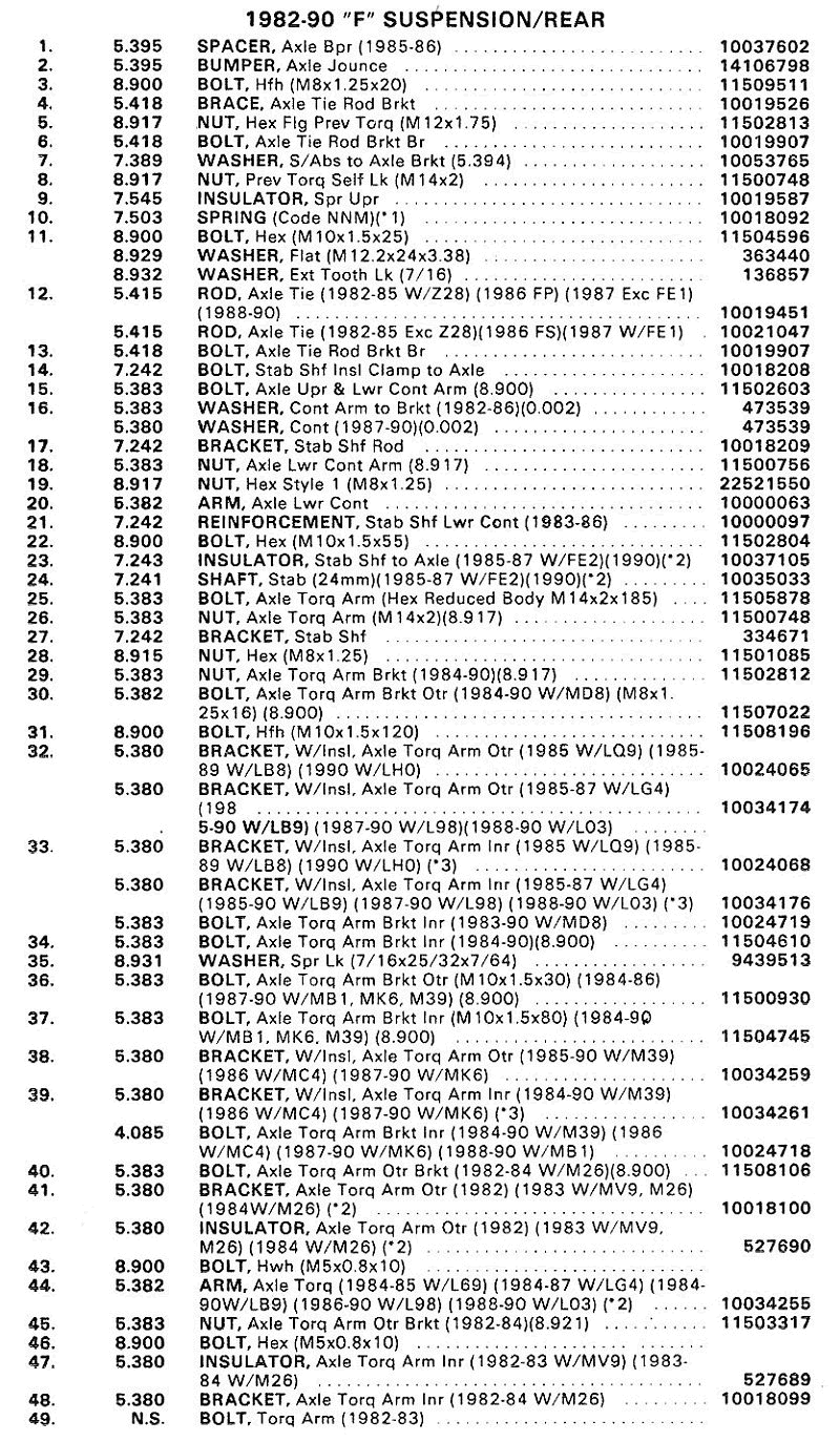

Here are 2 pages for '82-'90.
Will post again with 2 pages for '91.

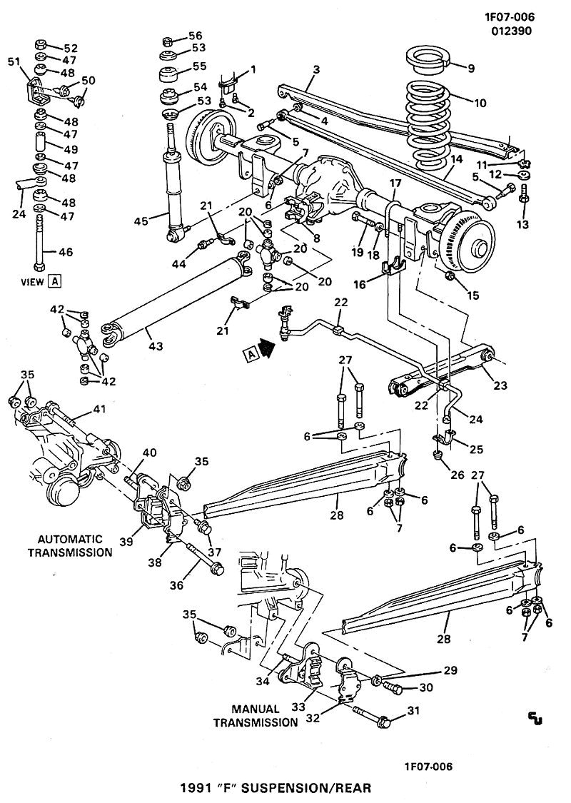

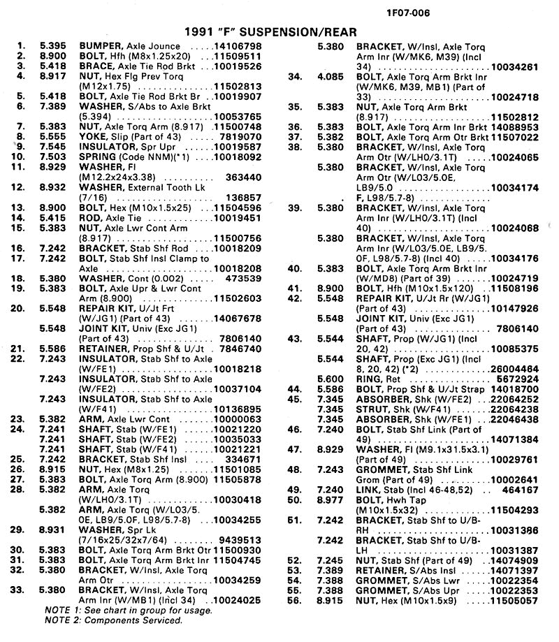

Here are the 2 pages for '91.
Hope this clears up info.
Nope, but thanks. I am talking about the Front Lower control arms, or A-Arms as they are sometimes referred to.

Sorry for the confusion. Hope these 2 help.
Attached Thumbnails Front LCA Bushing Problem-6-02.gif   Front LCA Bushing Problem-6-03.gif

That only lists 1 bushing. I am looking for documentation which specifically states the bushing size difference for these early thirdgens.
