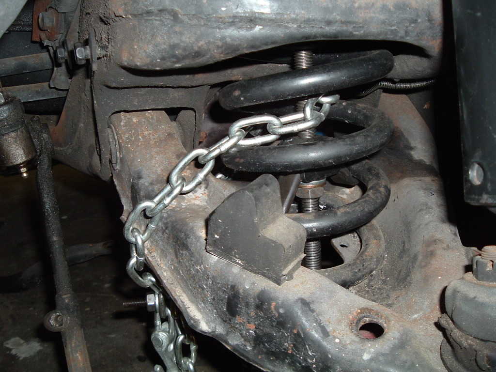

The inner spring compressor is just fine. I have used it multiple times. You NEED to use a 4" piece of pipe as a spacer like this. Its a bit of a brain buster to figure out what coils and how to arrange the hooks but this works perfectly. Took me about a hour or two the first time I have ever done it. Now it takes under one hour to completely do R&R the front.
This is the best way to do the front springs with a compressor no ifs ands or buts. Its a bit quicker to wrap a chain or rope around the spring and A-arm and lower the arm to get the spring out but good luck getting it back in.
BTW this is what almost all of the stang guys use amoung others to remove and replace the springs. Not really a new concept just not widely known.

I did something similar to Blackbmagic, but I added a nut on the compressor shaft instead of the spacers.
You can see if between the 2nd & 3rd coil from the bottom
