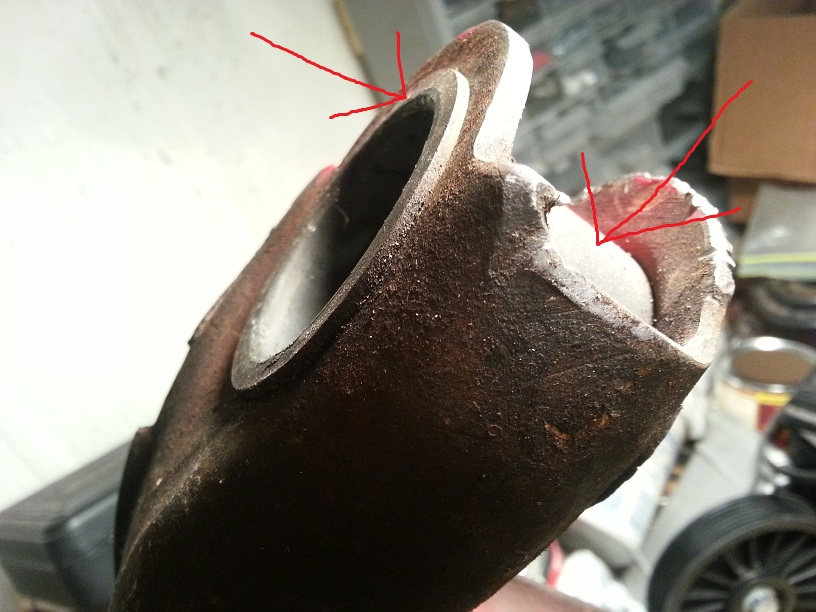

I'm trying to put new Prothane 7-220-BL bushings in my front LCA. I have the old rubber bushings out already. Am I supposed to remove the metal "casing" (see red arrows in pic) also?
I did a search but can't find the answer.
Thanks a million!

yes. easiest way is to collapse them and pull them out

If you (or anyone else viewing this thread) owns or has access to an air chisel, those make short work of the casings. Just hammer the flared ends in and hammer them out. I'm sure there are many ways to go about it though.

Thanks midnight! I don't have an air chisel so I used a sawzall to cut a chunk out of the casings and then used a regular hammer & chisel to get them out.

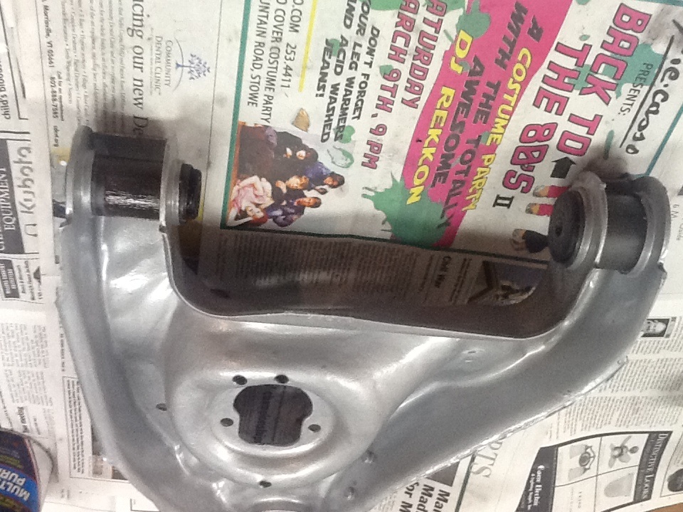

Yes, I just did mine, it does take some thinking. You have to make sure you have good spacers to put between the arms when you press in the bushing and it does take a lot of force.

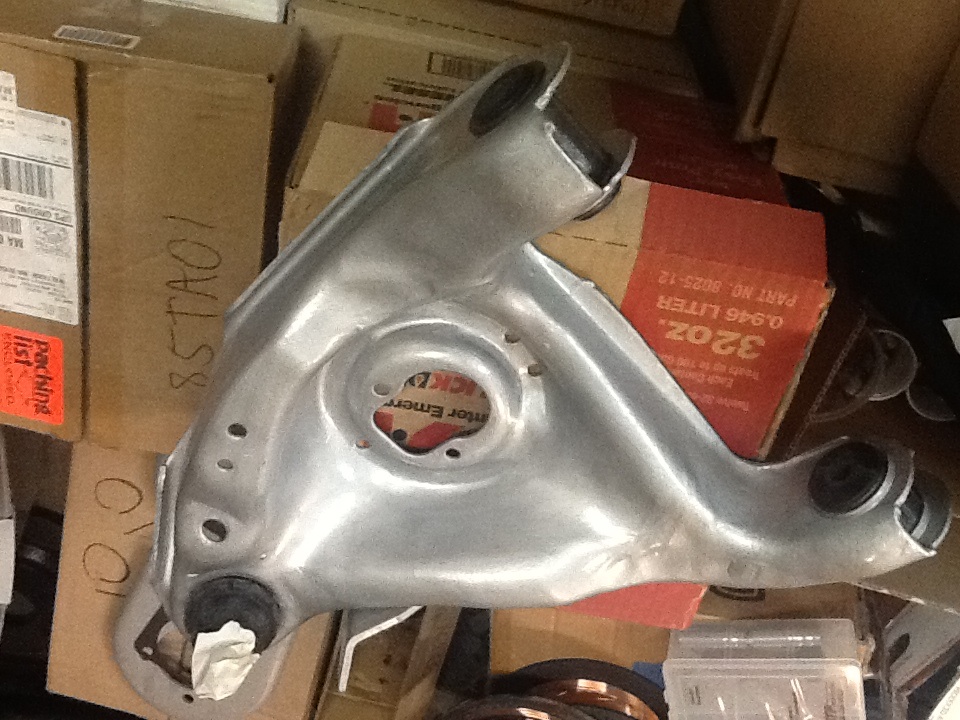

Another.
