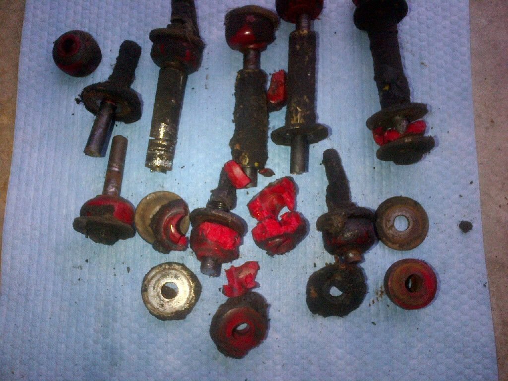

Was working on the car yesterday and see that my front sway bar ends are shot.They even had small pieces of the red bushing falling off. What Sway bar end would you buy rubber or poly?
