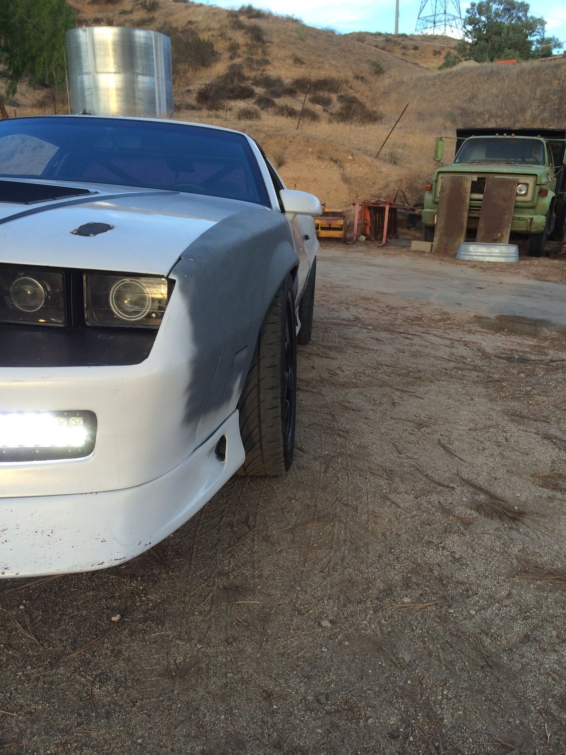

Hey guys, I have bean working on a set off struts for the past few years, as well as changing some geometry . I built the shocks from scratch from the ground up . With the help of my buddy Kieth and guidance from dean....
Old Sep 27, 2015 | 11:45 AM
morrow's Avatar
Joined: Mar 2009
Posts: 865
Likes: 15
From: simi valley, southern cali
Car: 92 Camaro Rs.R
Transmission: wc t-5
Re: The Grip, Part III - Shock the monkey
My rear shocks vs a jri .. Mine is the silver one
