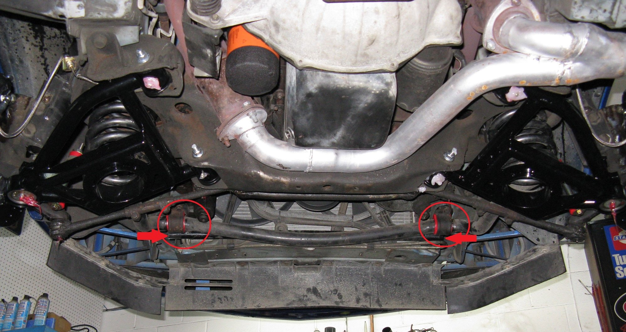

I recently bought a wonderbar for my base firebird. I need to know where and how to bolt it up. Pics or diagram would be most appreciated!!!! Thanks for any help I can get!!! EDIT thanks for the replies its on.

It connects on the brackets that hold your front sway bar.

drop the sway bar down... put the bar up to the same holes that the sway bar bolts to..... bolt sway bar back up..

1. Block rear wheels, jack up front of vehicle to good working height. Place jacks stands in a secure location.
2. Locate the front sway bar; loosen both ends links, one is located on the passenger side and the other on the driver’s side. Do not remove them, loosening them will allow you to lower the sway bar.
3. Remove all (4) bolts from the front sway bar bushings. Lower the sway bar enough to insert steering brace.
4. The steering brace has the correct holes to be bolted under the front sway bar. Insert the brace and line the holes in the correct location. One side is intended for the driver’s side and the other for the passenger side.
5. Swing the sway bar up into place. Use the OEM bolts removed and place the sway bar back into place. The bolts go through the sway bar and the steering brace. Loosely install all (4) bolts before tightening.
6. Tighten ends links and lower car to the ground.
If you need anything let us know.

Thanks that worked like a charm. Will be using your products alot in the future.
