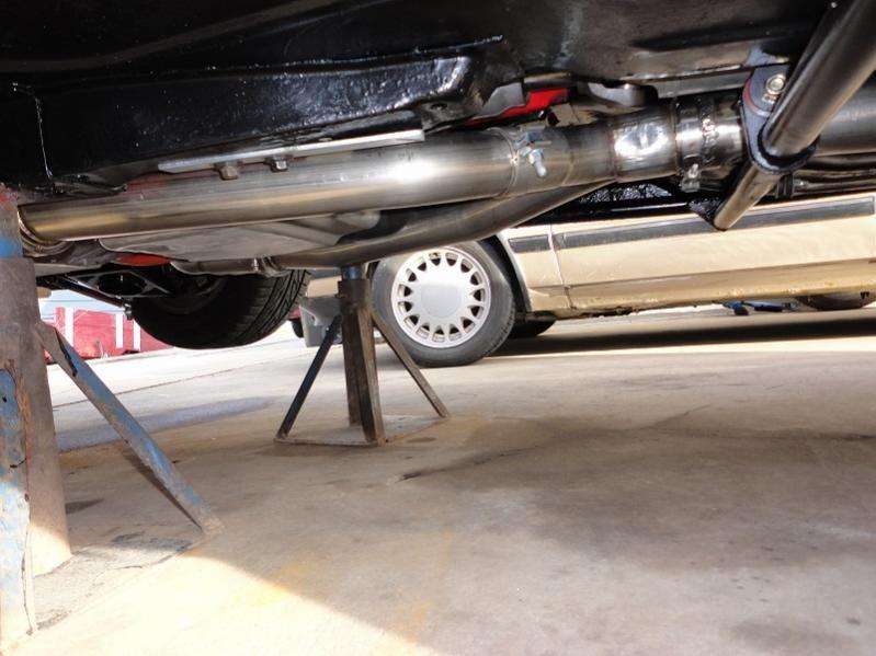

Yeah, the entire underside is being addressed next so I can tuck bigger exhaust in the tunnel when the car is lowered.

If I can fit 3" exhaust around a 4L65e, you can do it around the T-56.

Thanks for the reply TEDSgrad. I'm cutting so I can fit exhaust inside the frame specifically at the bottleneck at the rear of the boxes. That's the only way I've found to get significant clearance to lower the car. Looking at your exhaust the setup sits well below the frame and the trak pak hangs lower than that. This what I'm looking to remedy so I can keep the car lower for street driving.
