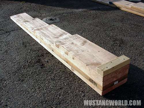

Go out and buy two 8' lengths of 2x8 pressure treated lumbar. Make a 45* cut at 4' another at 3' and the last at 1'
Glue them one on top the other with construction adhesive and screw them together. Screw down a strip of 2x2 at the very front to act as a bump stop. You now have a set of ramps under $20. You will no longer have trouble jacking the car up.

You mean like this?
This is a good option also.

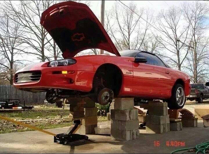

And now for some entertainment.
Old Aug 20, 2017 | 11:46 PM
Ghettobird52's Avatar
Joined: Apr 2010
Posts: 1,027
Likes: 11
From: Modesto, California
Car: 88 Firebird Formula
Engine: LO5 5.7 TBI/Ebl Flash
Axle/Gears: 2.73 stock rear end
Re: jacking on the pinch-weld - adapter?
lol lol made my night
