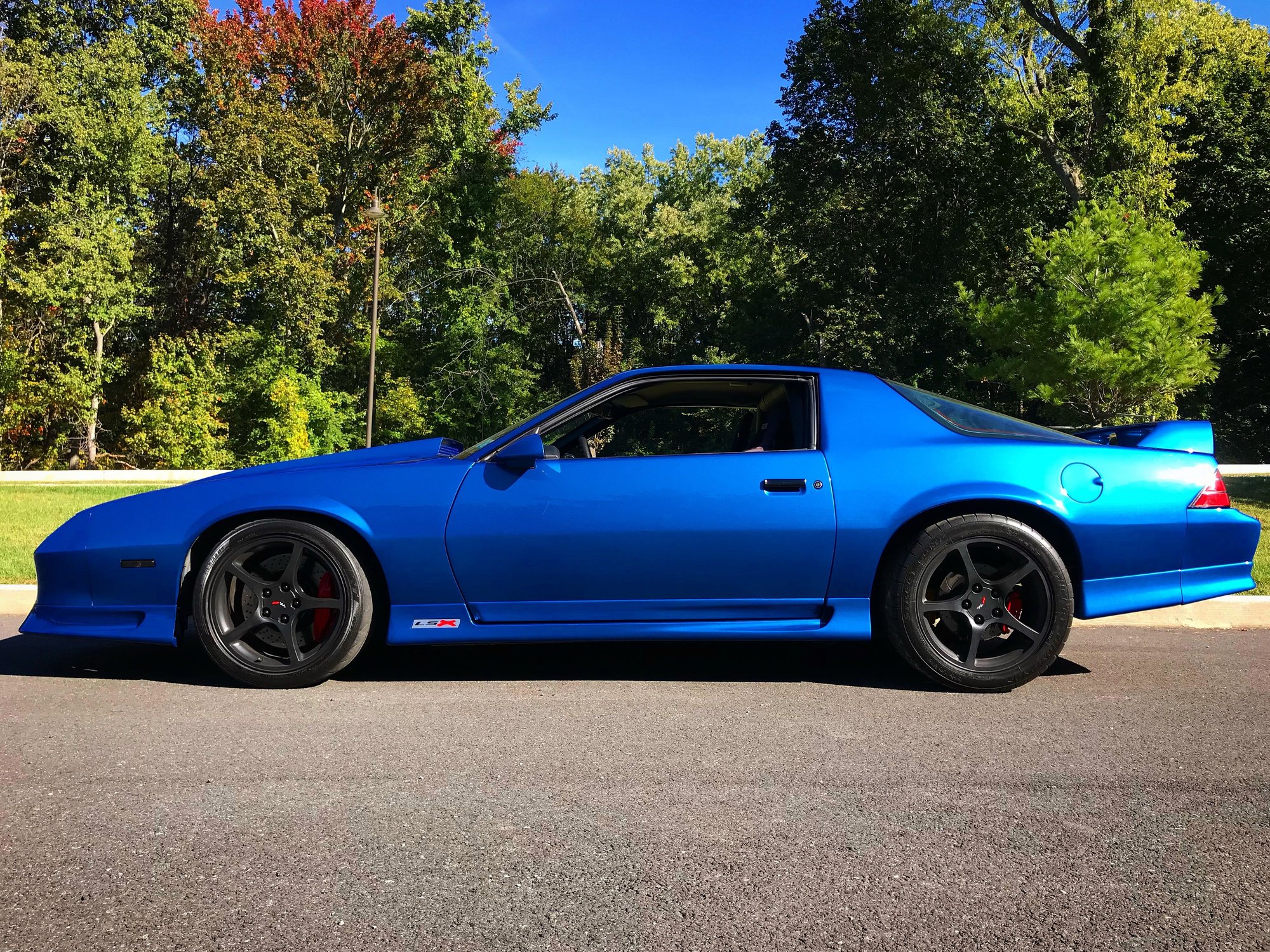

I don’t have any experience with Intrax springs, but maybe the design of the bmr arms had the suspension sitting differently in the front. Im running Eibach Pro springs all around. Koni yellows, stock A arms. No rubber isolators in the front, and replaced the thick rear isolators with heater hose on the top two coils.
Man what color is that?! It's beautiful!!
Thanks, it’s Hyper Blue Metallic. It comes on the new 6th gens.

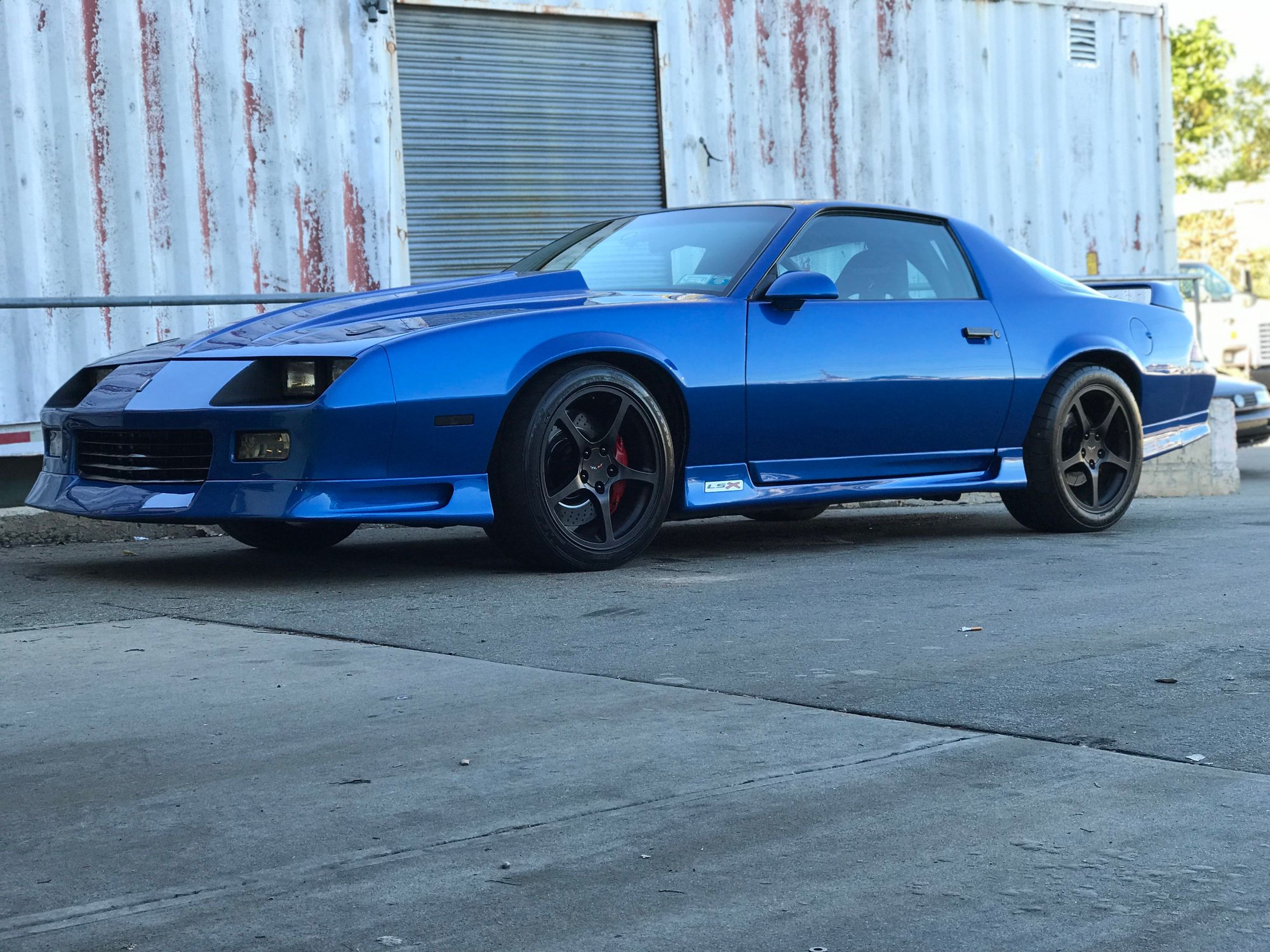

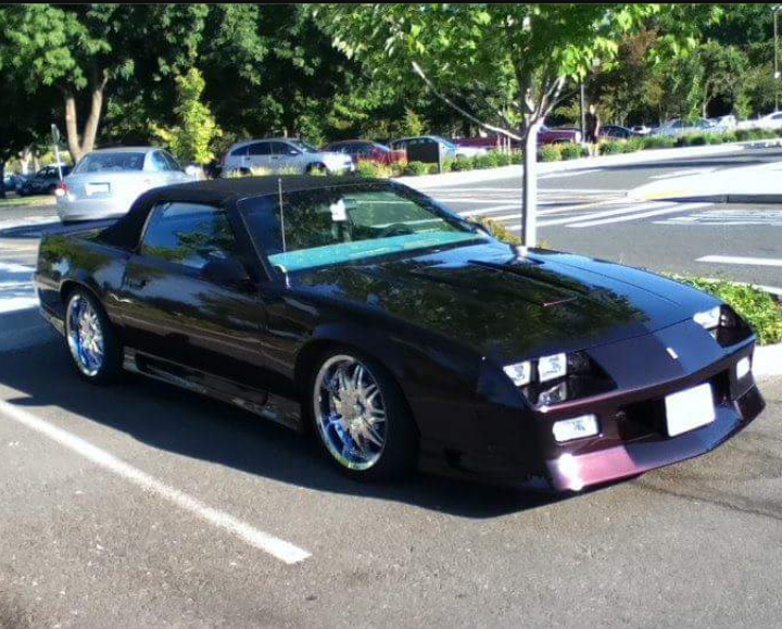

these are photos of how it was about a week ago. I will take pics tomorrow of how it is now from a side view. I measured the distance from the center of the wheel well to the ground of the front and rears. Front is 26 5/8 inches. Rear is 26 1/4 inches.

Nice color; I like it.
