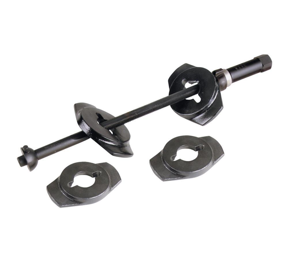

OTC Front Coil Spring Compressor
I'm curious on thoughts on this specific tool. Does it make you feel safe when you are using it? Or is it still a scary experience? Has anyone used it and not been happy? I've seen people suggest this to people around TGO and they still opted for the other claw like tool.

I have that exact model and I love it. I feel mostly good about using it since the pins lock the plate from rotating. As with any system that stores energy, I don't want to be in the path of the projectile when it is compressed. Not nearly as much pucker factor when using this one though. I would give it a 9 out of 10, it can be a bit of a pain to get the top plate in a good position since it is shrouded by the spring pocket (usually) Would definitely recommend. Make sure you keep the bearing lubricated and grease on the screw, and I would not recommend impact too use.

That looks similar to a Kent-Moore tool ($$$$$$ )I had back in the day. While I never had any problems with it while rebuilding many Olds and Chevy front-ends, I don't think any spring compressor would make one feel completely safe.
My best advice here is to avoid any such tool made in China.
what do you mean by this?

Without being there is is hard to describe. I have used it on several vehicles and getting the top plate in position can be a little difficult. It's not terribly difficult, you may not even feel the same if you were there doing it. It was easier than using one of the finger/claw type though

It's just one of those things that you should respect that there is an incredible amount of energy stored in the spring when it is compressed. As spring compressors go, I think the OTC tool is well made, and a good design. It is likely a direct copy of the Kent Moore that ironwill said. I wouldn't hesitate to use it, just understand that it will be a projectile if you drop the assembly and it breaks. It's the same as as standing under a lift really. You're putting your life and trust in a man made tool.

That is the business.
It's on my to-buy list. Seems to be the absolute best way for the front springs.

The biggest issue with a spring compressor is the top of the compressor hits the bottom of the top spring pocket
This spring compressor does not have that issue
