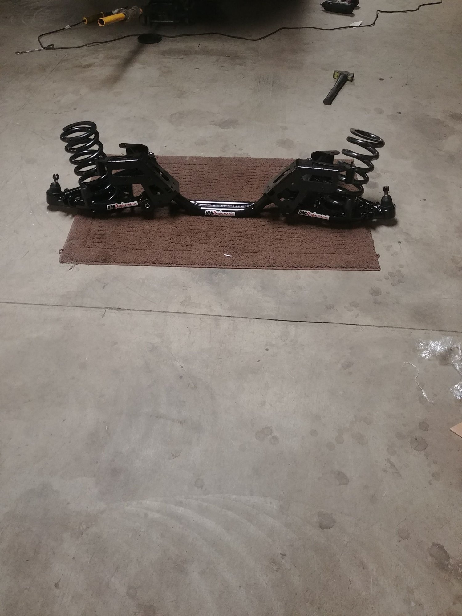

I have the umi front eng goin in. Real nice stuff. Check the umi site though. They were shut down for the virus. I got my k member back on the black friday sale. Road race version. Just got a-arms and wonder bar from summit last week. They had em in stock free shipping

Just box it up and ship it to me. Exactly what I am considering right down to he color. What brand springs?

thats a eibach pro kit. Got wonder bar, koni yellows, new strut mounts all to go in during the hung flu shut down. Did the whole Midwewst chassis rear suspensipn last fall

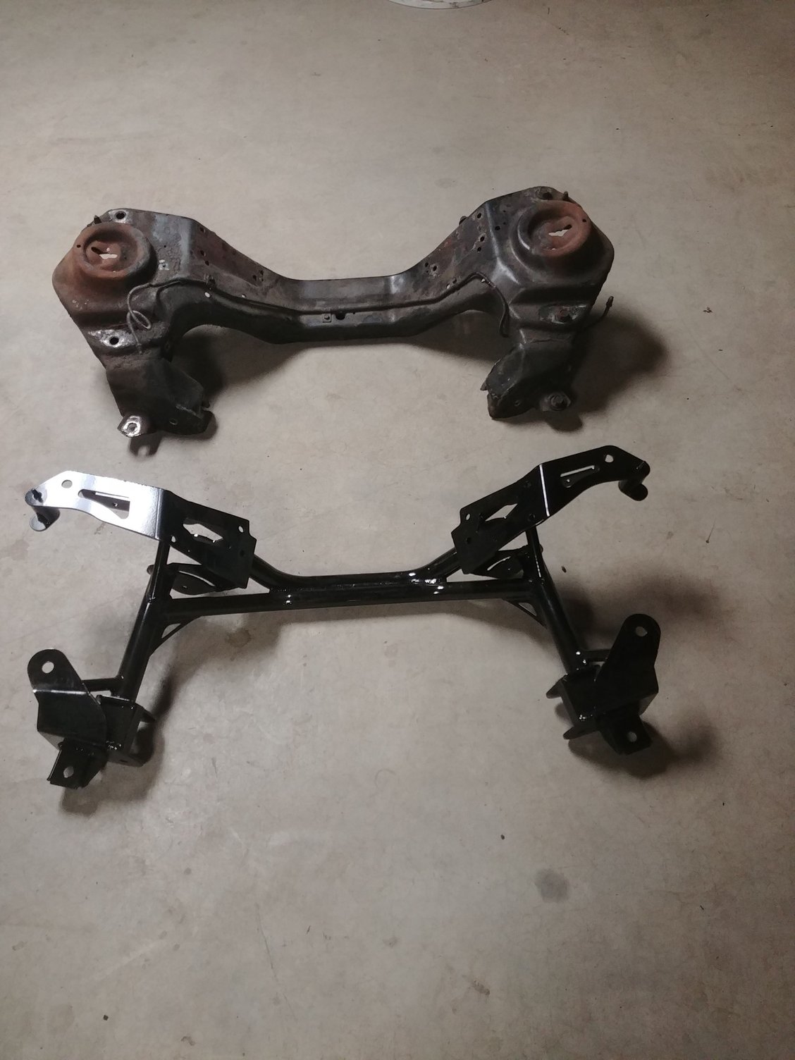

Got the old k member out last night
Should clear up some room
