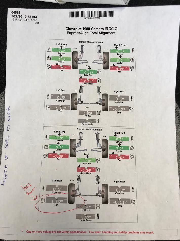

So I just got my car back from the shop, my driver side axle housing is bent, but I'm not sure if that's causing the issue.
I had gotten into a fight with a curb a few years ago, finally piecing the car back together...
What could cause the car to shake so rough? Dash pad starts bobbing up and down pretty violently...

Never had a shaking issue like this until about 2 years after I got it, I spun out and slammed into a curb with my driver rear first, and then the front.
I replaced the lower control arms and panhard bar, needed to replace the axle as well.
I took it to the shop to get the frame straightened, and it's there I found out the actual axle housing is a bit bent. Here is a picture of the results.
I'm getting a donor rear end, and the shop is going to try to align her again, we shall see how that goes.
Now I am not sure if the shaking is still caused by that rear end, or if it could potentially be something else... Perhaps like a busted motor mount? Im simply unsure.
No further troubleshooting or parts replacement is warranted until you first correct the bent rear end housing. When tracking down any problem, fix the obvious issue(s) first.
