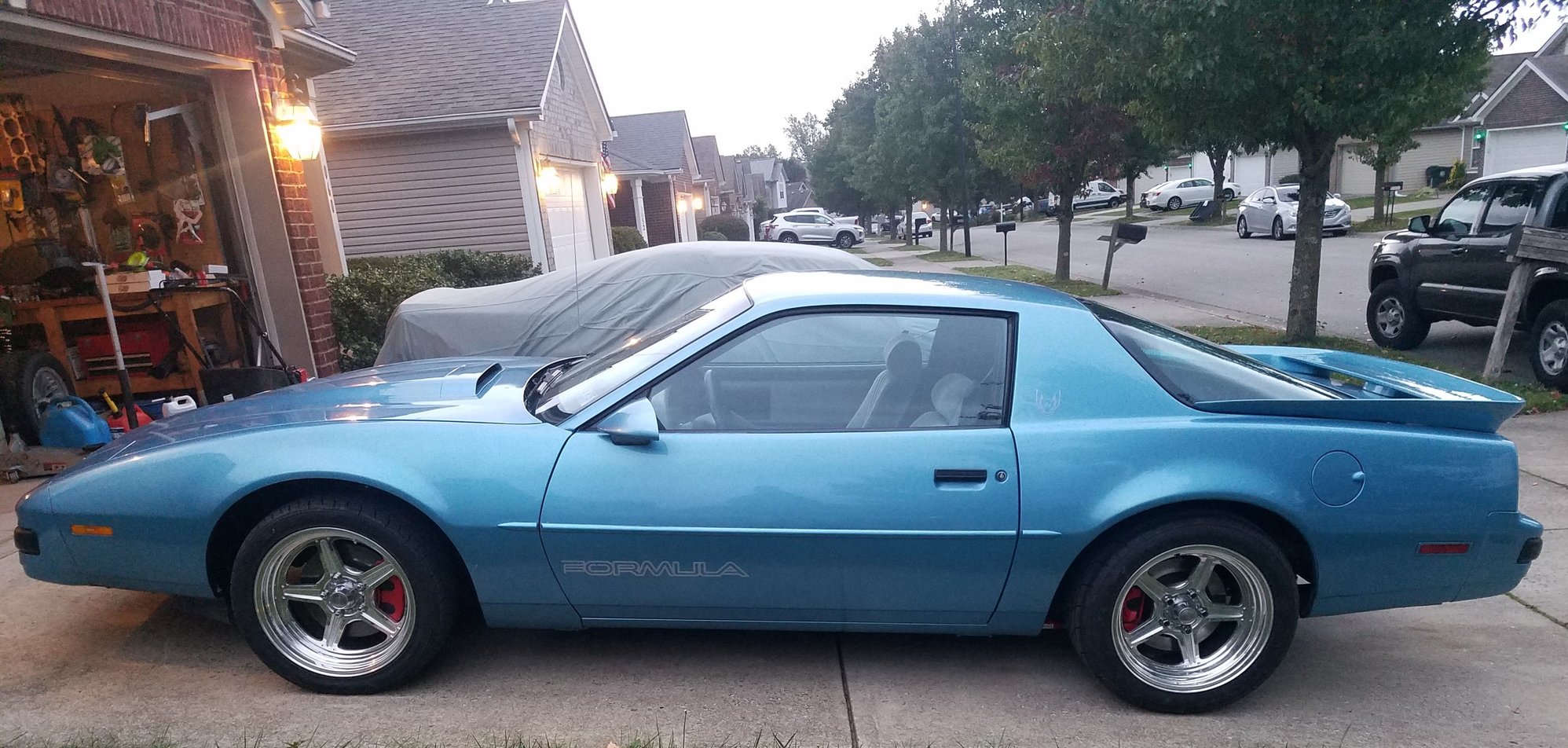

I installed the BMR coilovers on the front with Lakewood struts. I was hoping it would lower it more as the pic below is at the lowest setting. I modified the lower spring perch to get it down some more. I have since raised the rear up so that it sits level now.
At the lowest setting as purchased:
Modified spring perch:
