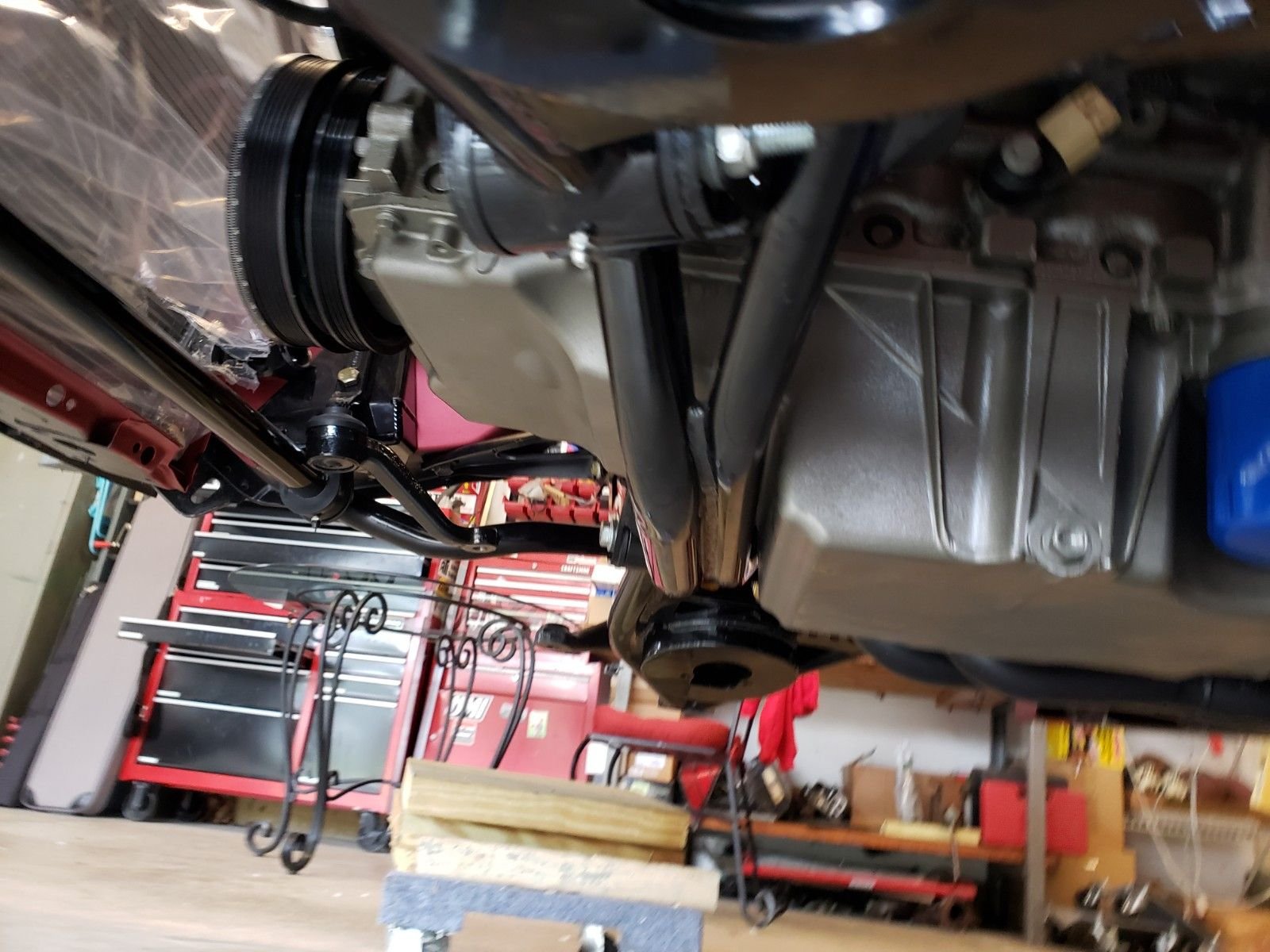

Or even the C6 Bar which looks more similar to Phil's
