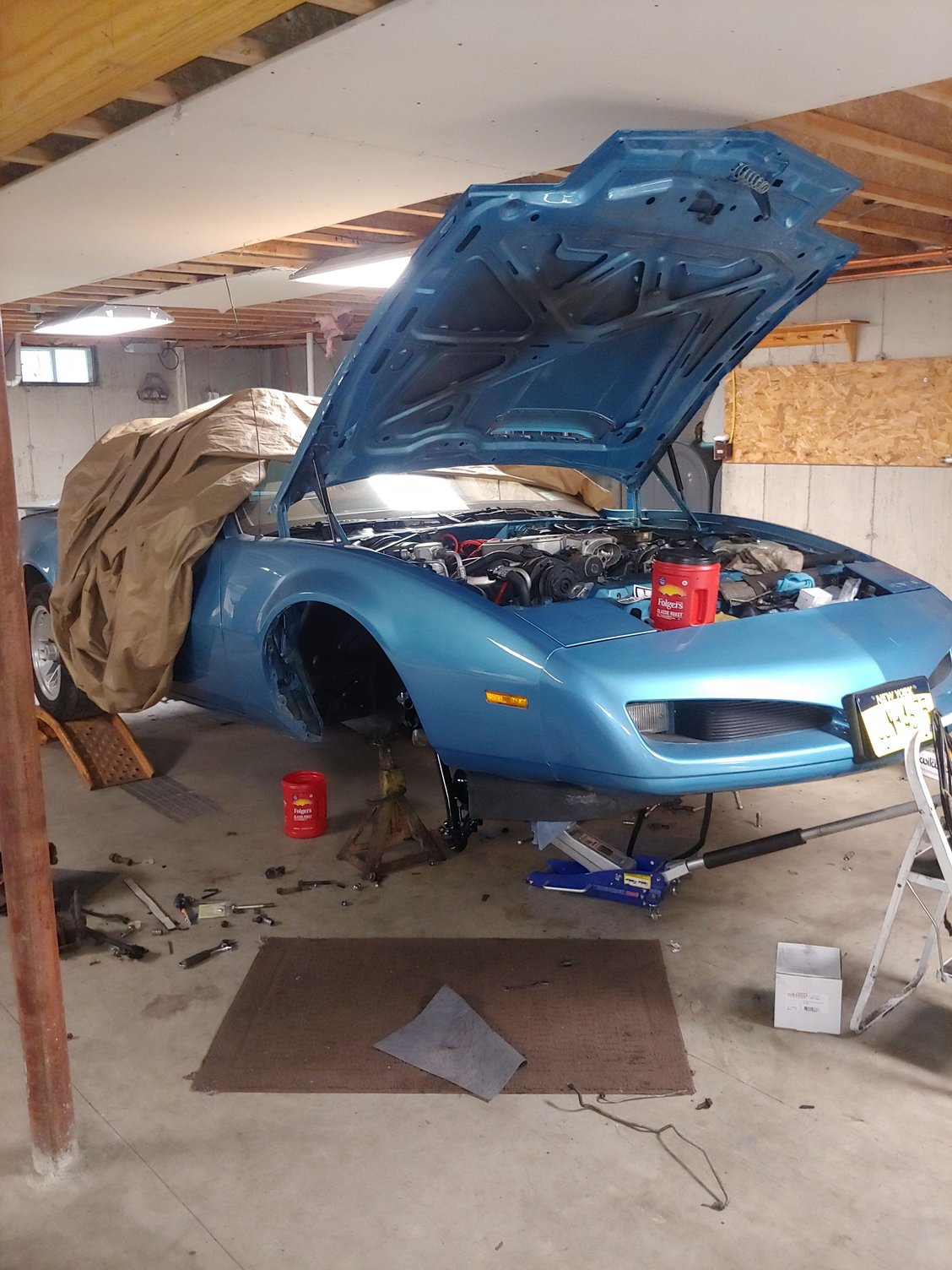

I set tbe rear wheels up on wheel ramps. I suppose you dont have to, i did a ton of work with it in the air though. Its probly safer with the car in the air and level too. Less chance of it moving on ya.
I forgot to mention earlier that its real squeeze getting the member in if you have long tubes. I actually scuffed mine a fair bit. But lots more room when done.
I've always loved that blue on 3rd gens, but I've never seen it on a 90's 'bird... that's hot.
I currently have the passenger side head, intake, header and exhaust off, the driver's side is still on, so I figure now is a good time for the swap, half the **** that might get in the way is out of the car...

I just removed mine this weekend with the help of an engine support bar and the expensive otc spring compressor and everything went perfectly. I did have to bend and stretch the drivers front brakeline to get it around control arm mount but bent it back the way it was after finished with no problems. I do have a question for you guys. Is it possible to get the k member crooked upon installation? I assumed the 2 alignment pins and bolt holes would line it up the way it was before but It looks shifted more to one side. I noticed this after I had everything put back and bolted down of course.
The factory crossmember can move a little on the alignment pins, but not more than, maybe, an 8 to a quarter inch? Aftermarket could potentially move a lot though
Since my motor mounts wouldn't line up, I tried it- I put washers under the bolt heads covered in grease, and once you tighten them to the point where they're flush with the surface but not tight the alignment pins hold it dead on, there is no sliding it around at all.

Well thats good news as I dont want to take apart again. I cant stress enough to get the good expensive spring compressor. Ive used those cheap ones and had the arms slip. Its worth its price by not having to go to er lol.
