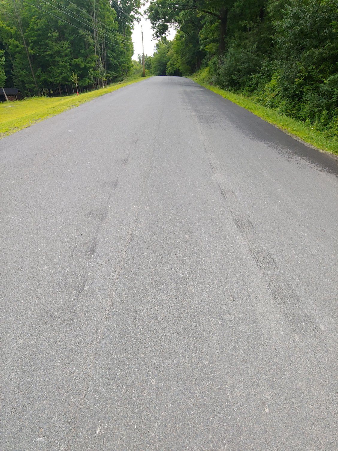

Third Gen's don't wheel hop.
GD
Idk about all that. All stock, high mileage parts mine wouldnt really hop unless it was top of 2nd gear when it broke free. Did all rod end control arms and panhard bar with a new rear and detroit locker. Made it almost undriveable (see pic) absolutely violent. This summer I switched to koni yellows, eibachs and a midwest chassis torque arm. Its much better. But still gets bad when under certain conditions. Maybe its somethin with the locker, thats when it got bad. But to say they dont wheelhop is a potential gross understatement
