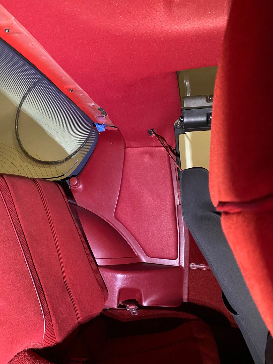

Good deal, I am jerking around with the interior. Just got the headliner, sails, and sun visors done. Still putting them back in. Kinda weird to see the contours again, with the old fabric hanging, very happy with this repair.
