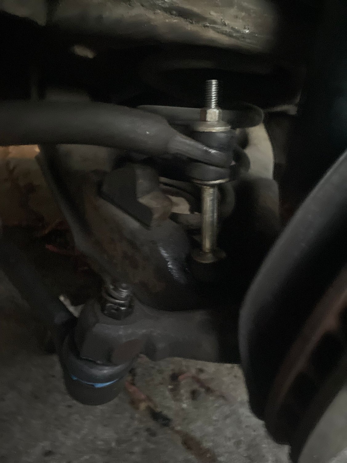

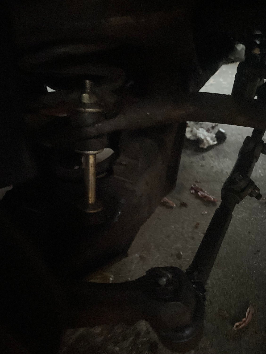

is there something wrong with my sway bar? my endlink bushs look warped after instal
Old Jul 10, 2021 | 01:36 AM
mjensen71's Avatar
Joined: Apr 2021
Posts: 6
From: Oakland
Car: 1991 camaro rs convertible
Engine: 3.1L v6
Transmission: 5 speed manual
See attached.
this is passenger side sway bar end link with bushings.
This is driverside side sway bar end link with bushings.

Re: is there something wrong with my sway bar? my endlink bushs look warped after in
Sway bar might be upside down, or you haven't raised the a arms yet to ride height.
