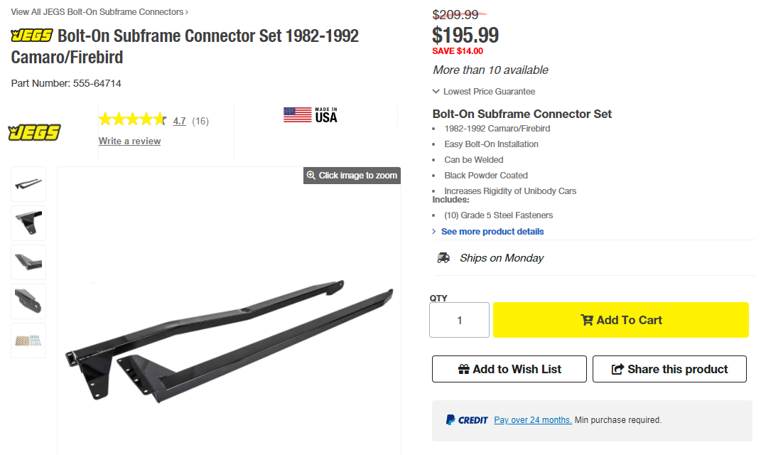

Jegster Bolt-In's FTW !
Do you have a part number on those? I couldn't find them on Jeg's website.
Old Feb 5, 2022 | 03:47 PM
ramblingarage's Avatar
Joined: Jul 2021
Posts: 79
Likes: 61
From: Janesville, WI
Car: 1989 Trans Am GTA
Engine: 5.7 TPI
Re: Bolt In Subframe Connectors
Maybe I spoke too soon..

Alstons DO NOT use pre existing holes, wait til you try drilling holes on the rear sub frame w/ the LCA box close by. The angle to drill is severe....
and from the Jegs instructions.
3. Remove the door sill cover and pull back the carpet in the area of the front bracket. Using the bracket as a jig, drill 3/8” holes through the floor pan and install the bolts w/ flat washers on both sides of the bolt. Drill the frame hole at the rear of the connector through the hole in the bracket and install the bolt with flat washers on each side and tighten the lock nut.
Only the rear (LCA) is a true bolt on.
