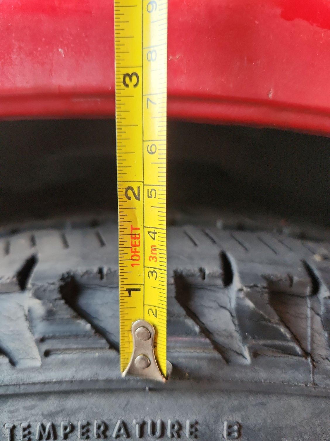

Installed a new rear end and now I cAnt get the rear even. it's an inch off. I'm assuming it's the spring clocking but I've moved the low side around to get it to match the higher side and I'm not having any luck. Words of wisdom? The driver side is so low I. CAnt drive it.

Measure THE CAR, not the trim (fender).

bottom of car to the ground? measuring 3 areas on each side i found the driver side is 1/2 inch lower at all measured sites
