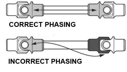

Joint phasing issue?

hmm i have honestly never heard of that. i know i di have my bro look around as i was moving the wheel and catching when the bind would happen. he said it sounded and felt like it was right at the bottom the steering column by the top U-joint of the steering shaft. that is why i replaced the bearing cause i thought that was it (well it was also bad). i will have to look at the shaft and see if i can orientate it a different way. thanx for the video.

so i decided to try and find a pic of the shaft when i got it and looks like joints are lined up incorrectly. now i guess i will have to see if i can fix that.
weird thing is im looking at other shafts like the walter racecraft and others and the u joints are set up the same way mine is.
