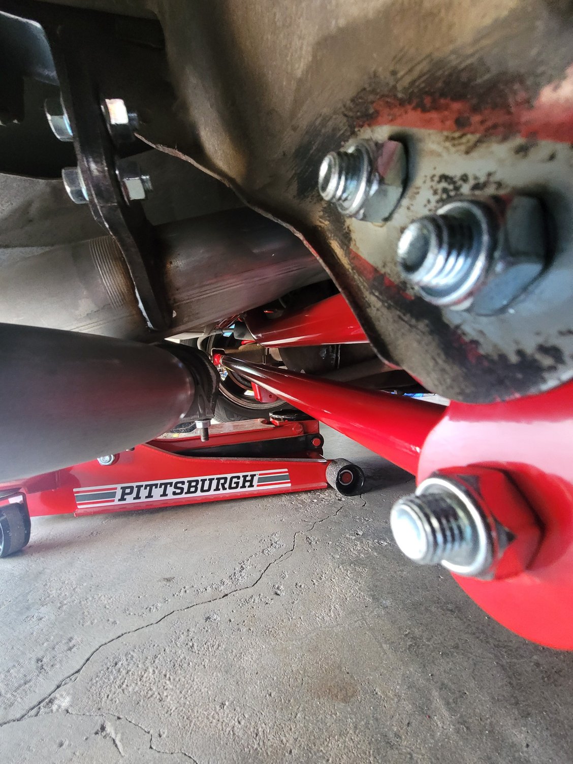

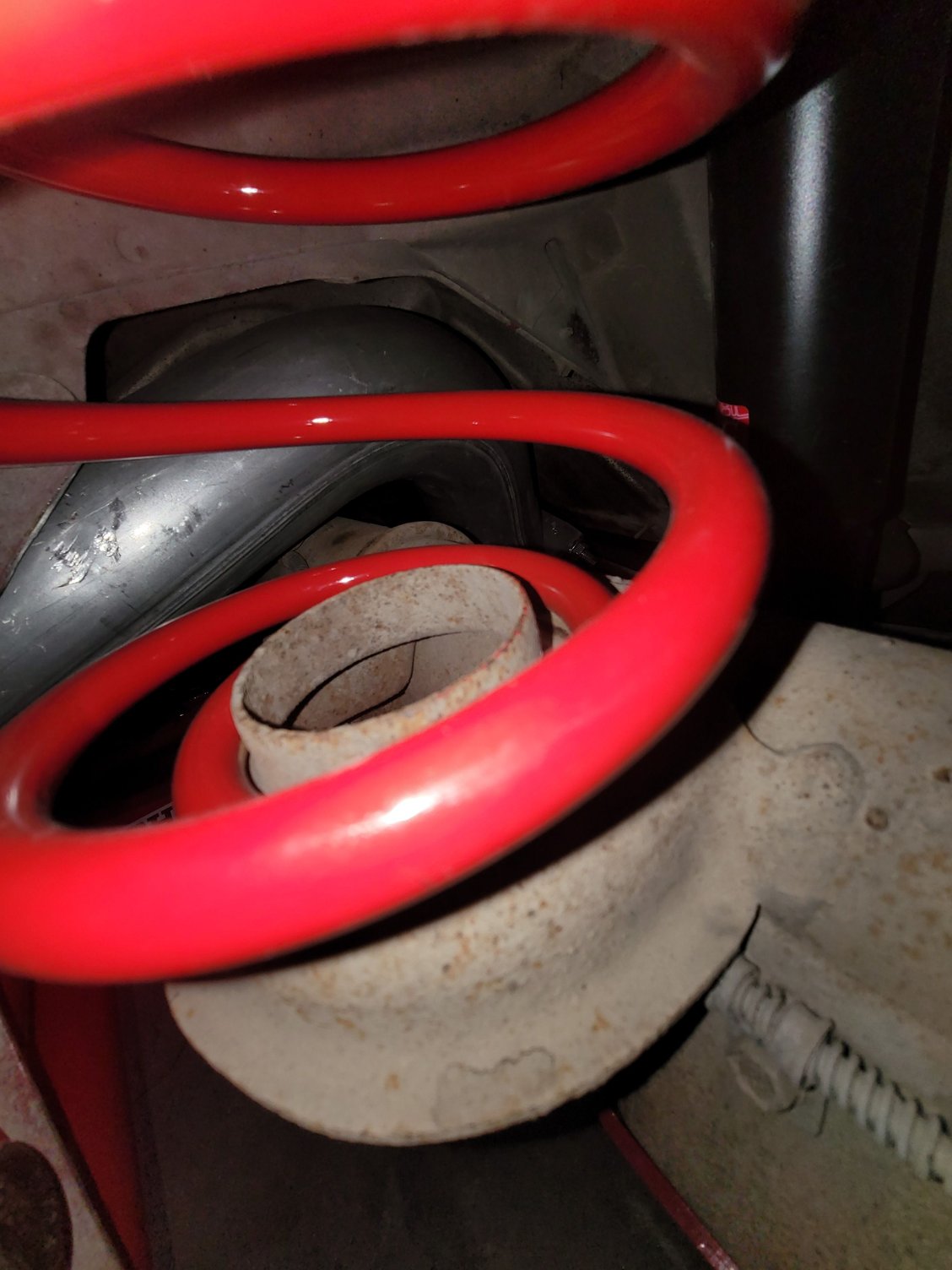

Here are pics of the springs sitting on the tires. Do these look like they should? I don't know what a binding spring looks like. Do they need to sitting in a certain spot on the lower or upper seats, i.e. I need to rotate them?
Bumpstop distance while on the tires was 7/8" on the passenger and 1 1/2" on the drivers.
Also are pics in each direction of the upper support and lower panhard. No visual marks on the bars, so I don't think they are not hitting. The panhard is angled up towards the drivers side (Driver is 11" off ground and Passenger is 7 1/2"). One thing I did notice is the sway bar seems high compared to what it was before. I swear the bar was right below differential and now it is even with the bolts. I changed out the swaybar endlinks and tightened them underload. Do I need to tighten them more to bring the bar down?
LCAs are in the higher holes on the relocation brackets (Founders has two hole options) and are parallel to the ground while sitting on the tires.

The sway bar will move "up" a little, relative to the rear diff cover when you lower. ....Kinda hard to see in the pictures, but things "appear" ok after a quick glance. That panhard is way out of level though. I understand you're saying it's NOT hitting, but in my mind, it sure seems like it's a very real possibility. 3.5" is a LOT, and even if it's NOT hitting.....it's certainly not ideal.

Even if you can't SEE a problem, I'd still do what qwiktrip said. Pull the springs and use a jack to simulate range of motion.
