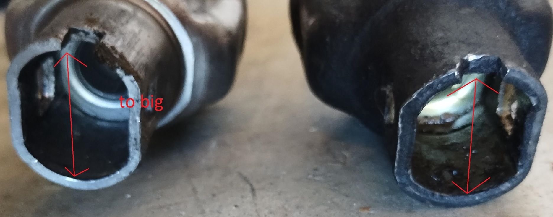

I think all my steering woes are related to this POS Summit racing reproduction aftermarket Chinese steering shaft. They claim it is for G-body and F-body but the end coupling is to wide at the curved ends. So it pivots on the bolt and ***** on the end of the firewall shaft, as wheel input is applied. Garbage for F-body.

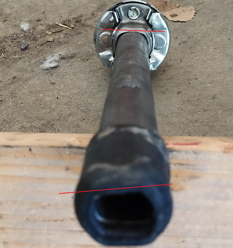

Also another problem is poor quality control, when they crimp the rag joint end on the shaft, it is out of alignment. So when the car's steering wheel is aligned straight during a four wheel alignment, the shaft is holding the steering gear in a slight turn position even though the steering wheel and wheels are straight. Pic attached to explain. Easier to see when you hold in your hand and eye ball and then compare to factory shafts.
I've installed a low mileage factory Camaro shaft and will have to have the car realigned to restore to factory settings.
Absolutely the reproduction shafts can be trash. I used an OER branded shaft from Classic Industries for several years and the steering got progressively worse. The entire assembly and assembled fit are garbage. Installed the original GM shaft again, not even rebuilt, and instantly improved the steering.
