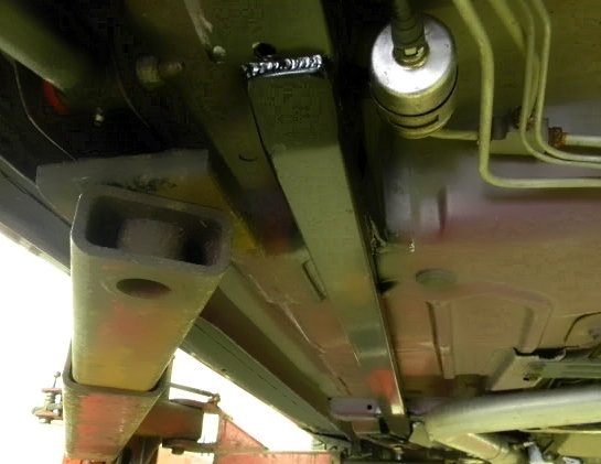

I would want to see some install pics or at least something better than what they are showing. The pieces that they show
look like straight tubing instead of something that at least tries to follow the contour of the floorboard. I have the Alston inners.
They are not perfect by any means as they hang a little low but made quite a difference. I have a t-top car so I also added
the UMI outers so the car is pretty solid at this point.

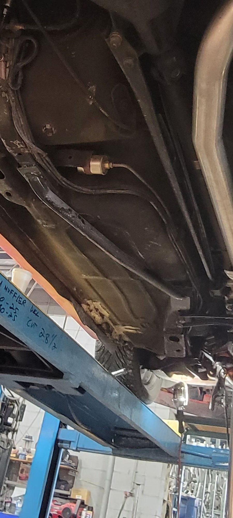

Those straight bars just don't look like they will line up to the rear subframe. There seems to be no rear "pads" like the front.
I have Alstons also, welded, and they have to contour so there is exhaust clearance. These look like you weld these in and everything else has to fit around them instead of the other way around.

They kinda look like the subframe connectors I got for my Camaro back in like 1998. They were just two chunks of raw square tubing... Had to cut open the floor to pass through and weld it all together. Can't say I'd do it again if I had to but I will say, I can easily open and close the doors when it's jacked up at the front or rear and it won't make good contact on one of four jack stands because the floor isn't level.

Not sure if this is still a question or not? The Alston connectors route from the back of the front sub frame to the front of the rear
sub frame. The UMI outer connectors go from the rear control arm mounts along the rocker panels to the front of the car. There
are also ties back to the front sub frame. I also welded in a few pieces of small square tubing that bridge the gap between the
UMI outers and the rocker panel. This makes for a nice structure that in effect ties the everything together. I can also jack the
car up from the UMI outers very easily from the side of the car.

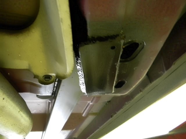

Awesome. That's what they look like installed

I have a set of Alstons and old CE square stock outers. I welded in the outers years ago and that helped a lot. I had a fabricator put the Alstons in. This guy builds multi million dollar drag cars. He does insane stuff (it was really cool to check it all out). He said between the inners he put in and the outers that were there, the car was good for any power level until the car has a set of slicks/tubs. At that point he said a cage would be necessary (not my plan). At this point the car is solid, no flex issues, no cracks in the roof/sail panels. The doors line up no matter how the car is on the lift or stands.
best of all, when I shift it really hard and beat on it, it is totally sold. And that's w sticky 305s in the rear.

There's install pics on the Midwest chassis website. From what I've seen there's no floor cutting at all it for from the subframe at the rear to the front subframe
Attached Thumbnails Midwest Chassis subframe connectors-subframe-1.jpeg   Midwest Chassis subframe connectors-subframe-3.jpeg   Midwest Chassis subframe connectors-subframe-4.jpeg   Midwest Chassis subframe connectors-subframe-2.jpeg   Midwest Chassis subframe connectors-subframe-5.jpeg

sorry i havent taken better pics yet, but here's them on my 88 TA. I like them but I decided to buy UMI's for my Camaro for the outer-style bar and the extra tie-in points. For $199 in todays costs though I'm pretty happy. The car handles night and day better, I've never put SFC's on a car - most already had them or didn't need them depending on the car. This has easily been the most impressive transformation after being so used to how it drove without them.
Main issue we ran into - my TA is a super clean chassis, no rust or corrosion anywhere but its had the flattened pinch weld area, and then also I believe it sat on jack stands for extended periods - the main subframe points are very crumpled . This led to my buddy using a lot of extra material and a LOT of extra welding to ensure it was sitting flat and even. It isn't pretty, he told me if anyone asks I did it with my $100 amazon flux core lol but it really isn't that bad especially all painted up.
These are only pics ive taken so far,
Tonight used the quick jack for the first time with them
