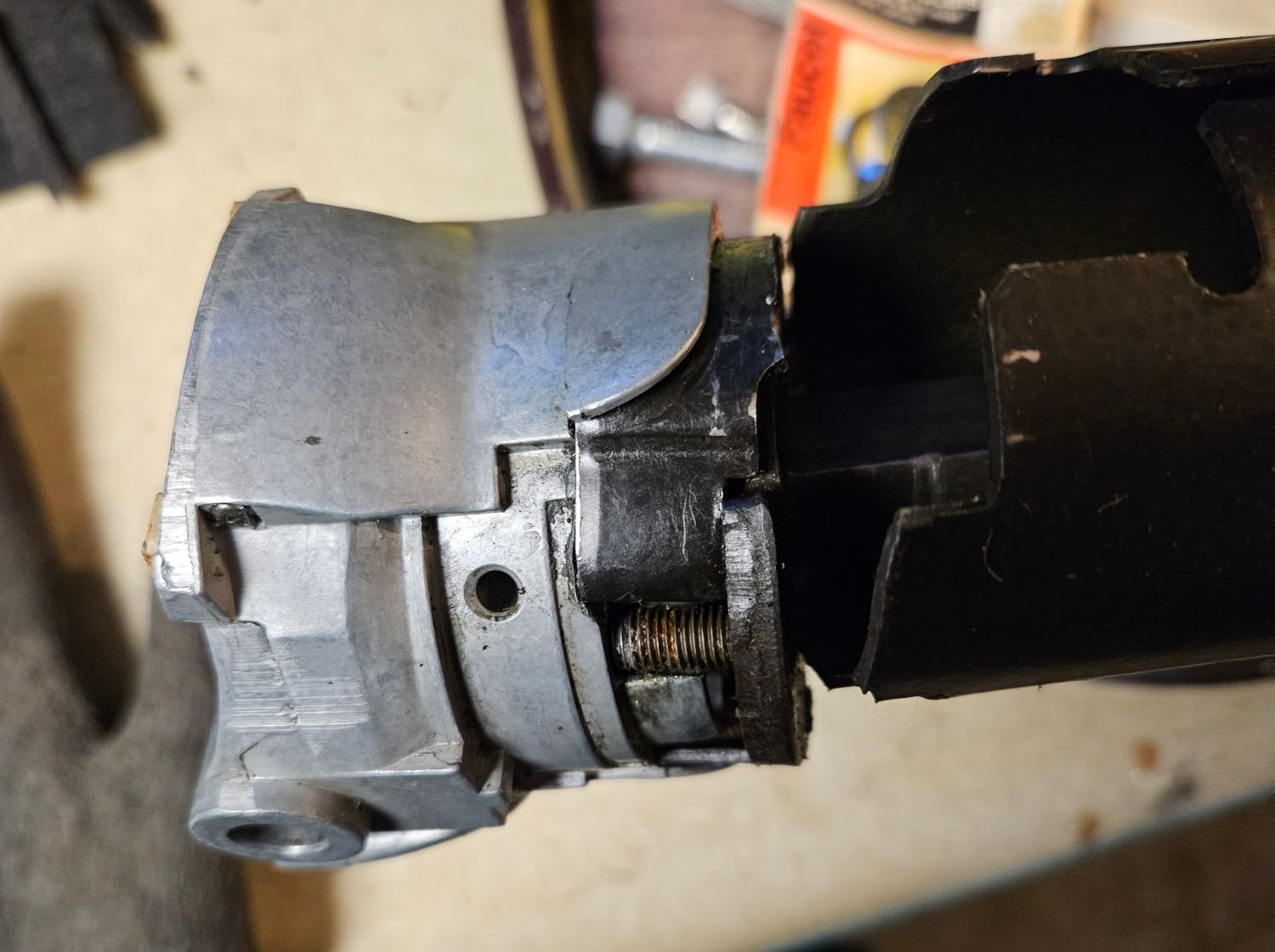

Hey all, my steering column broke recently and I'm not sure if I can fix it or if I need a new column. I don't understand it enough to diagnose if the shaft is fubared and I need help. I'm kind of stuck trying to fix this on my own, and I'm motivated because this is my daily. I appreciate any advice.
I'll start with my steering shaft is not centered in the column. Is this normal or fixable? Right now the steering shaft rests where gravity keeps it. You can lift it up and move it around in circles, like on the face of a clock. But the shaft will hold rotation position, like if you want to turn the wheels, that is fine. To be clear I am not talking about the ball joint that the steering wheel attaches to, that is fine, I mean the actual shaft that extends the length of the column.
I ended up taking it apart down to the steering column housing support and lock plate (you know the infamous 4 torx). I can see those components are not staying locked with the steering column shroud or whatever keeps them in place. They can free spin 360 on the shaft. When the column initially broke I was taking a left, upon returning the wheel to center the housing support rotated with it, so the blinker was at 12 and the keys were at 6, and the ignition actuator rod snapped. Years ago I tightened the 4 torx to spec and used locktite, they were still tight.
I would feel better about replacing broken parts I can see if I knew the shaft was ok and the column was salvageable. I know I might be dumb and it's probably the support assembly with the 4 torx that is messing it up, but I thought compared to any videos I watch the shaft is not loose and sitting at the bottom of the shroud in theirs.

Just sounds like the usual 60s - 80s GM tilt column fall-apart. Not too "hard" in and of itself, although, VERY tedious, and full of all manner of opportunities for things to go sideways.
However it also sounds like you let yours go too far, to the point that it fell COMPLETELY apart, and broke abuncha stuff in the process that doesn't usually break if you catch it before the steering wheel drops into your lap. To try to "repair" it is probably prohibitively expensive now, if not impossible (as in, parts no longer available). You'll probably come out money, time, and effort ahead, by just getting another column. It only takes about 10 minutes to swap out the whole column, if you're slow like me; you're probably smarter then me though, since EVERYBODY is, so you can probably do it quicker. Save yourself a WHOLE BUNCH of aggravation and unnecessary expense at this point, and just get another.
The "shaft" is fine. It's all that other stuff that's gonna drive you to drink.

I got my column swapped the other week. Wow! Not fun! My old intermediate shaft would not fit the new column. I thought I was crazy not being able to swap something so simple. As it turned out the receiving end was too small (overtightened and crushed in the past). Experimenting off the car, even with a column forced into it, it had play. So I resorted to using the JY intermediate shaft (had a torn boot I was avoiding dealing with).
Also reused some of my old parts. I noticed the order of wiper operations on the stick is different between an 88 iroc and 87 gta. Just goes to show things are always a lil complicated even with "a simple swap". All is good now
Here are the pics of my broken column Leave your best forensics guess as to what happened. Incidentally, my "original" column turned out to be a JY swap. Because stolen in '90s, maybe?
