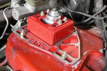

BMR seems to still offer a similar yet slightly different looking Set now.
Use the HyperLink below:
BMR

Yeah, I have seen those BRM units. They are OK.
There are actually quite a few companies that offer caster camber plates, but very few that offer as complete a solution as QA1 or DSE where the plates are designed in conjunction with the strut as a complete "system".
This completeness is what I am looking for, for my build.
