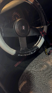

Got the good fellow at powersteering.com to rebuild my steering box. Great work but the car is all over the road. Took it by a shop and the guy confirmed it’s not the shaft but the box itself. He suggested tightening the wedge. Wheel and lower shaft have zero play but it seems the box doesn’t engage soon enough. Enlighten me, can or should I tighten said wedge? And how is that done correctly. Thanks!

Everything is new and replaced, torqued to spec. When you rotate the shaft you can see the box not engaging it until it turns maybe a 1/4 inch

Hopefully this works but with the car up off the ground this is the dead zone, so to speak, where it just doesn’t seem to have any tension. I’m steering hunting going down the road. Sloppy and don’t feel like crashing into a ditch over this…help appreciated
