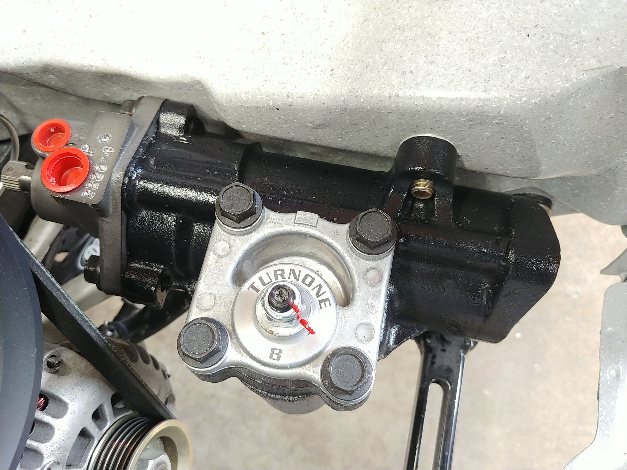

I've used RedHead to rebuild a Factory 3rd gen 12.7:1 box.
Good option for street cars.
I've visited their shop in Auburn Washington and shot the sh*it with their tech guys.
I've also used a Turn1 8:1 (600) box in my race car.
Had it rebuilt 1 time due to excessive lash.
Sent it in again this year thinking it was sloppy again. But it was Dyno tested and lash free.
So something else is loose steering wise.
Weird because I replace the entire steering system every year.
​​​​​​I wouldn't hesitate to use readhead or T1 to rebuild a box .
