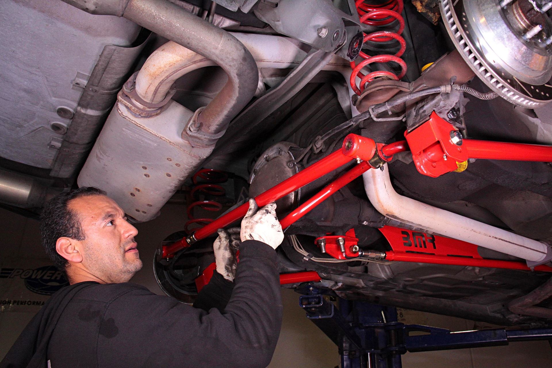

The upper brace doesn't have a pivot point as I recall. It's basically little more than a cross car brace. Not sure what you'd be using a 20 ton press on that thing, for? Are you talking about the red bar in this pic, or the black C-Channel brace?

I don't know what kind of goofery you're trying to do but there is no bushing to press out. It's just a bar held in place by bolts.
S&W has no crook in it and won't clear exhaust.
