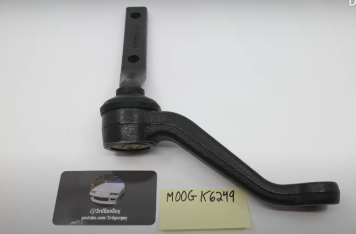

ULTIMATE Idler Arm Test

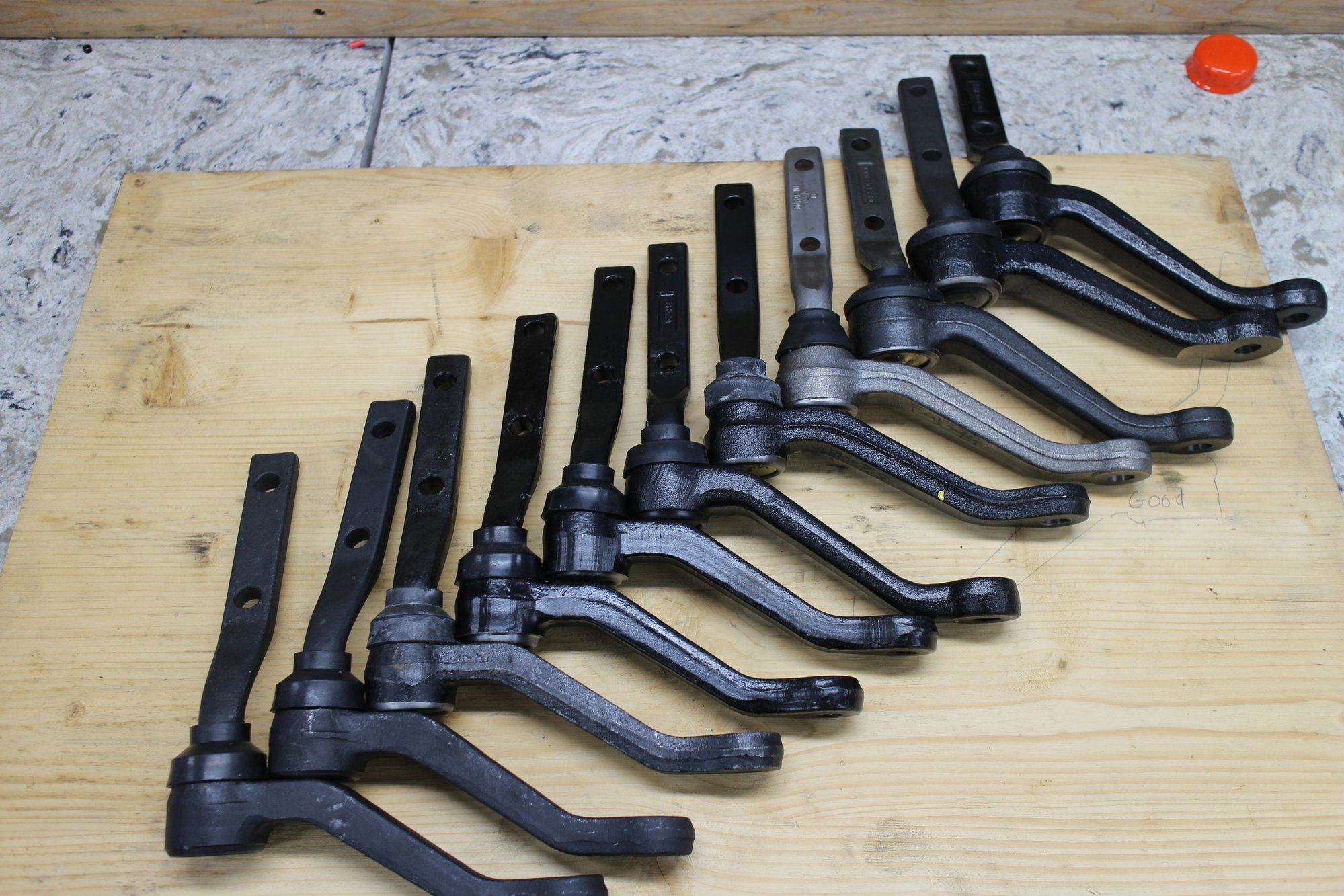

What idler arm is correct for a 1982-1992 f-body?
Who knows, so I made a video testing as many idler arms as I could find.

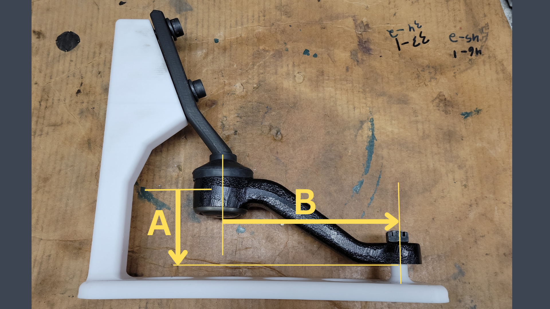

Bump steer was tested
& a test on my 3d printed jig
Turns out common knowledge was wrong, or maybe they changed designs over the years.
Make sure to give the video a watch
Video link:
(The Ultimate Idler Arm test 1982-1992 Camaro/Firebird)
all dem idler arms
all dem idler arms

Thanks, a lot for all the time, money, and effort you put into doing this. This is great information to know.

Thank you very much! I saw your video yesterday and immediately ordered two MOOG idler arms. I have Proforged on both of my V8 birds and was never really satisfied with them.

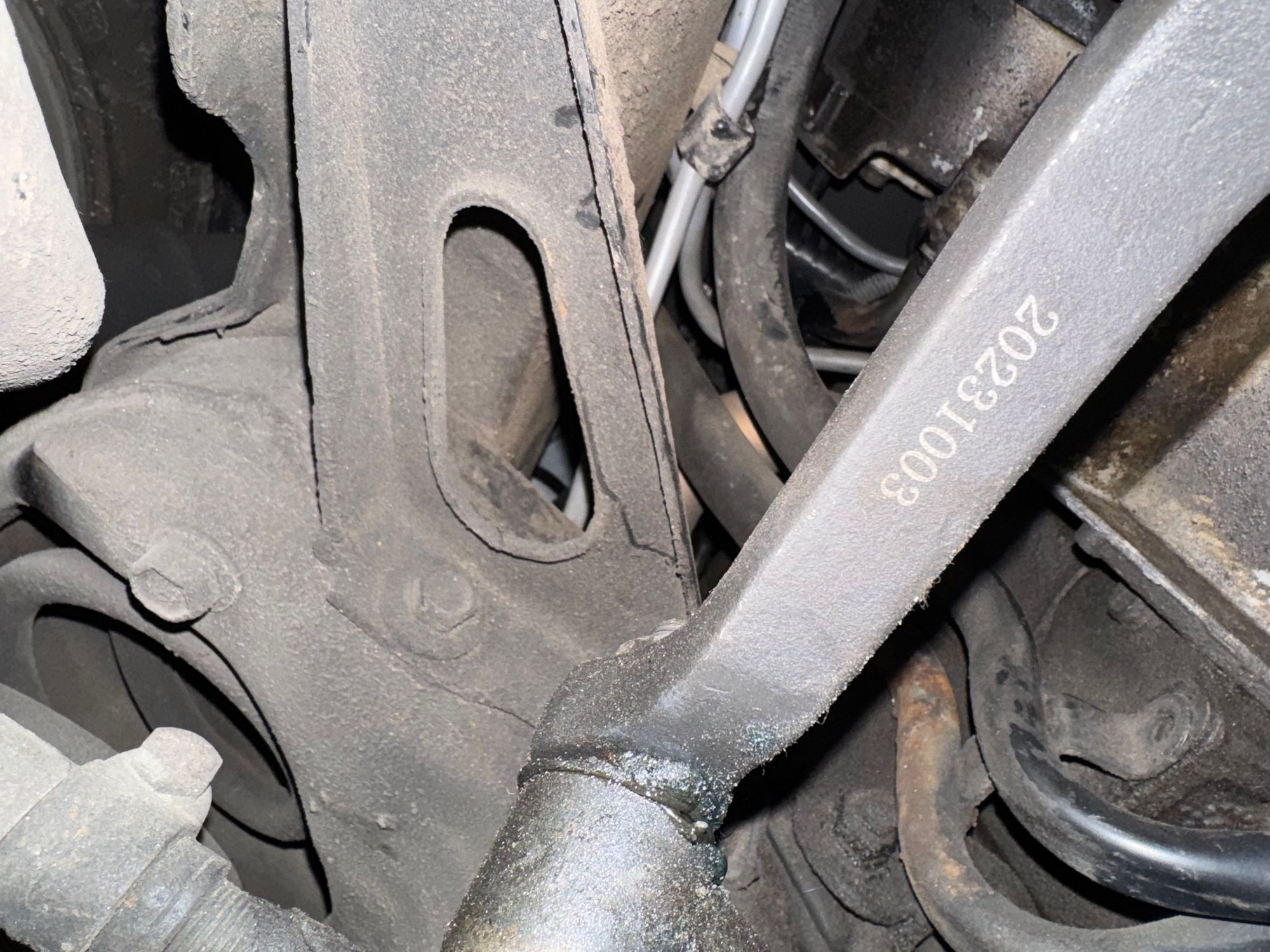

This is great information and maybe the place I might get some help. I have issues with wandering going straight and the steering wheel doesn’t return to center on its own when turning, the car is new to me so haven’t had a lot of time to wrench on it. I saw on another thread how aftermarket idler arms are not correct and could be a cause of my issue, I had a look and see my idler arm has 20231003 printed on it, I can find no reference to this and have no idea of the manufacturer, I was going to get an Acdelco part but after seeing this video I’m not sure aftermarket parts are all incorrect. Any ideas of who manufactured this part?

It's hard to say if the idle alarm is your problem or not. Those symptoms could be from a myriad of things.
I typically recommend people just rebuild the front steering. idler arm, center link, and tie rods.
Then replace the factory rag joint steering shaft with a solid Astro shaft.
And if the steering still feels terrible, have the steering box rebuilt by a reputable shop.
(No parts store junk)

I’m really curious as to the number on the idler arm, I can find no reference to it.

Re: ULTIMATE Idler Arm Test
Outstanding work !
Any chance we could get the partnumber for the MOOG one?
Old Dec 11, 2025 | 03:39 AM
McLovin1181's Avatar
Joined: Jan 2014
Posts: 387
Likes: 143
Originally Posted by Theking
Outstanding work !
My brother in Christ, all the part numbers are in the video.
