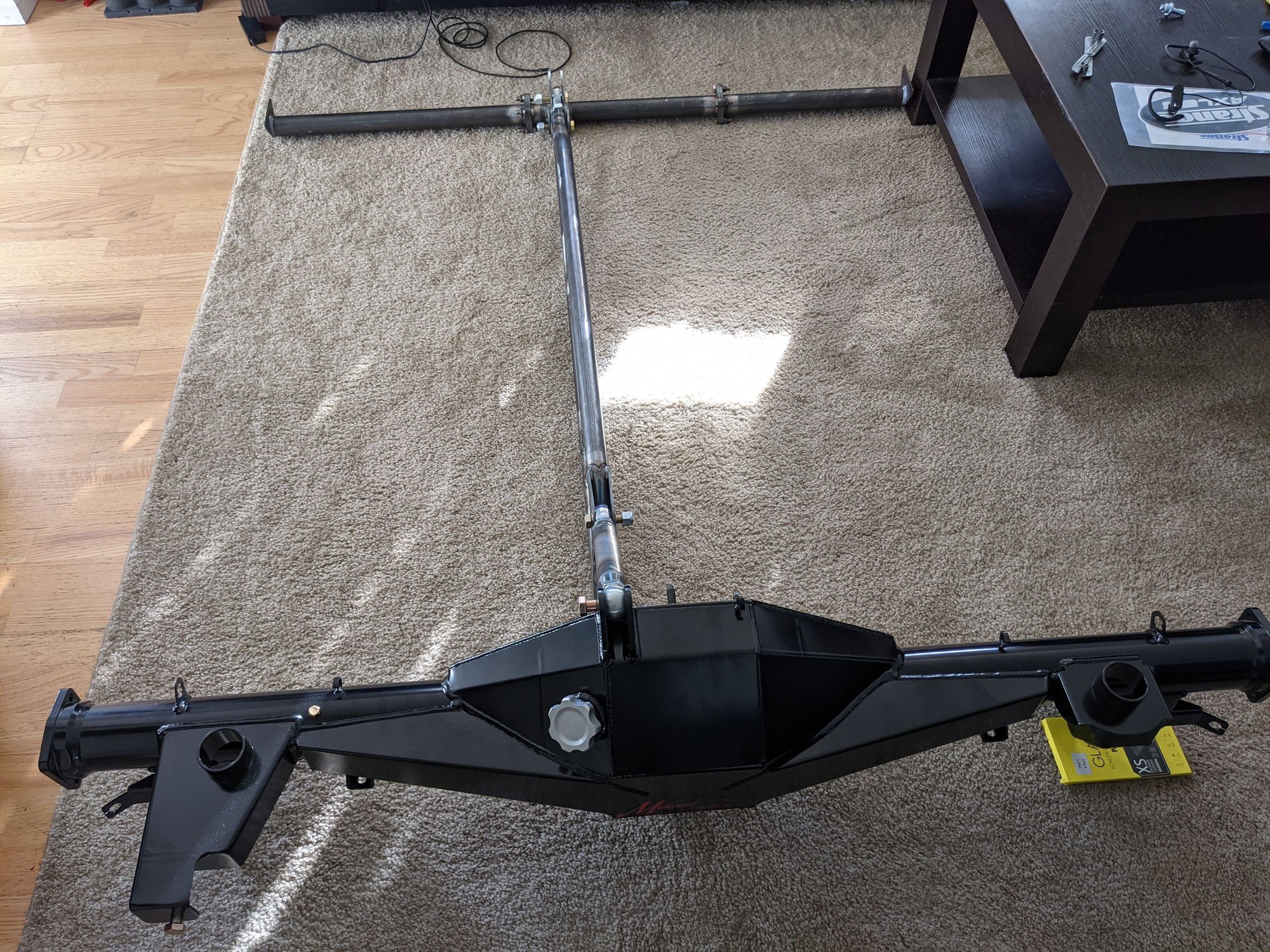

i have a similar setup to thatsupnow.
i have a Ford 9" with a 4L80E and installed a BMR Trak Pak torque arm that moves the arm off of the transmission. the Trak Pak mounts to a crossbar that i have welded between subframe connectors.
the tranny crossmember is a PA Racing unit. things are a little tight in the tunnel but it all works.
below is the best picture i have handy for your reference.

Thanks guys. Did you have to custom-make your dedicated crossbar, or did you buy?
Mine came with the entire rear end package. I believe the BMR Track Pack comes with a crossmember as well. QA1 makes a 4l80e trans crossmember and tunnel mount torque arm. Not a bad looking piece to just be able to bolt it all in with no welding needed
