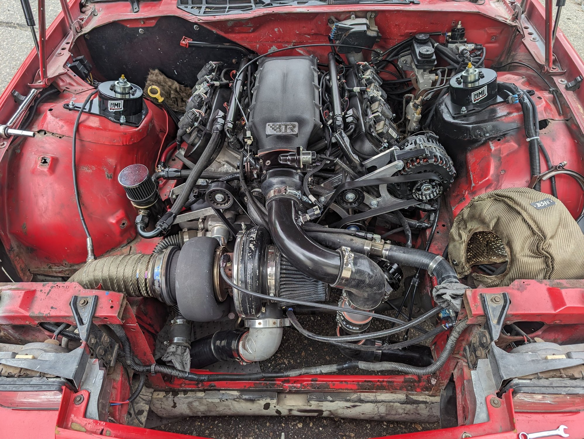

Ok. So here's the deal. I have my 87 iroc-z.
I'm in the prices of building my 6.0 / T56M combo.
Will be running single or twin turbo. Was thinking twins but after some chatting with Richard Holdner and my engine builder. A single will perform equally. Had anyone done a single turbo LS swap in a third gen with a tubular Kmember??
If so. Can I get some photos of how you piped everything? What were your obstacles/headsches? And how did you solve it?
Thanks in advance.
If this is not the right section, I apologize. I figured the Kmember would open up some real estate so I came here first.

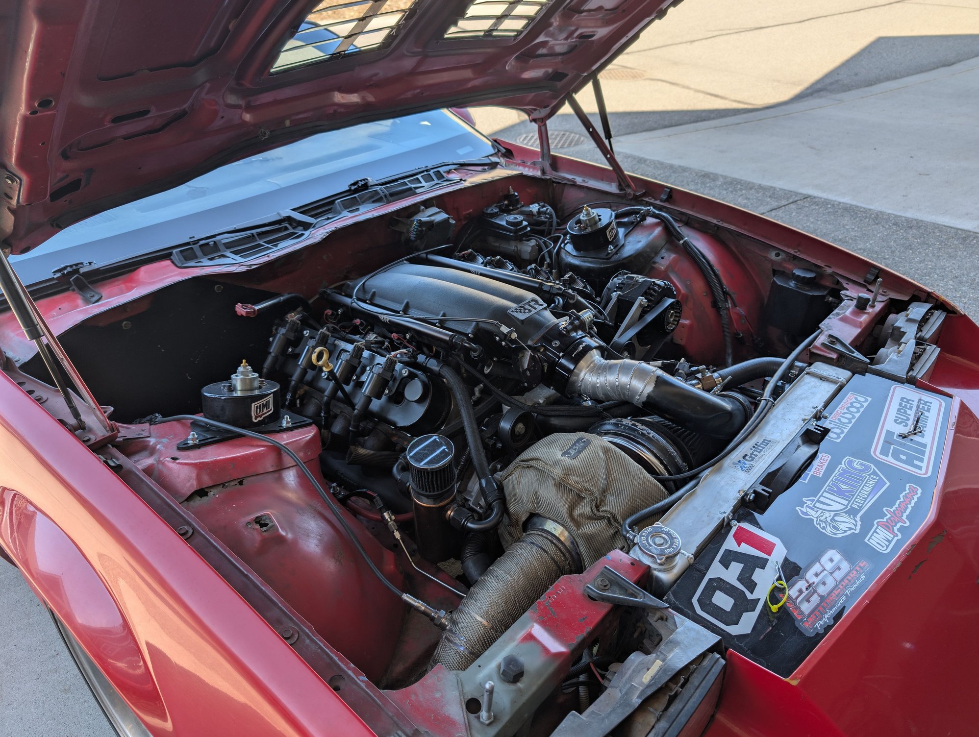

Joined: Apr 2010
Posts: 1,201
Likes: 126
From: Armstrong B.C.
Car: 1991 camaro Z28
Engine: Forged 370" LS turbo s488
Transmission: Built 4L80e FTI converter
Axle/Gears: MWC 9" 35 spline 3.25 gears
